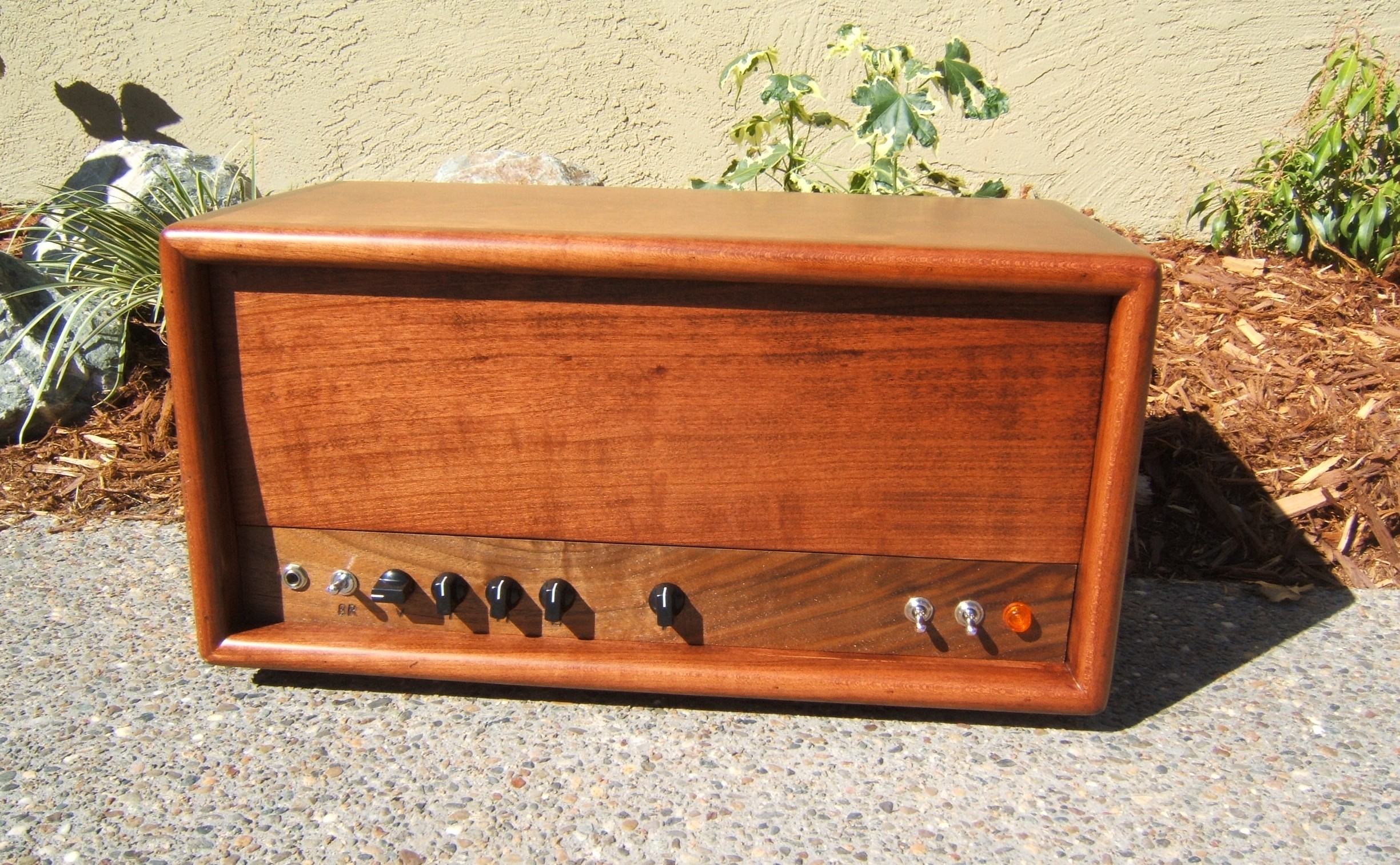

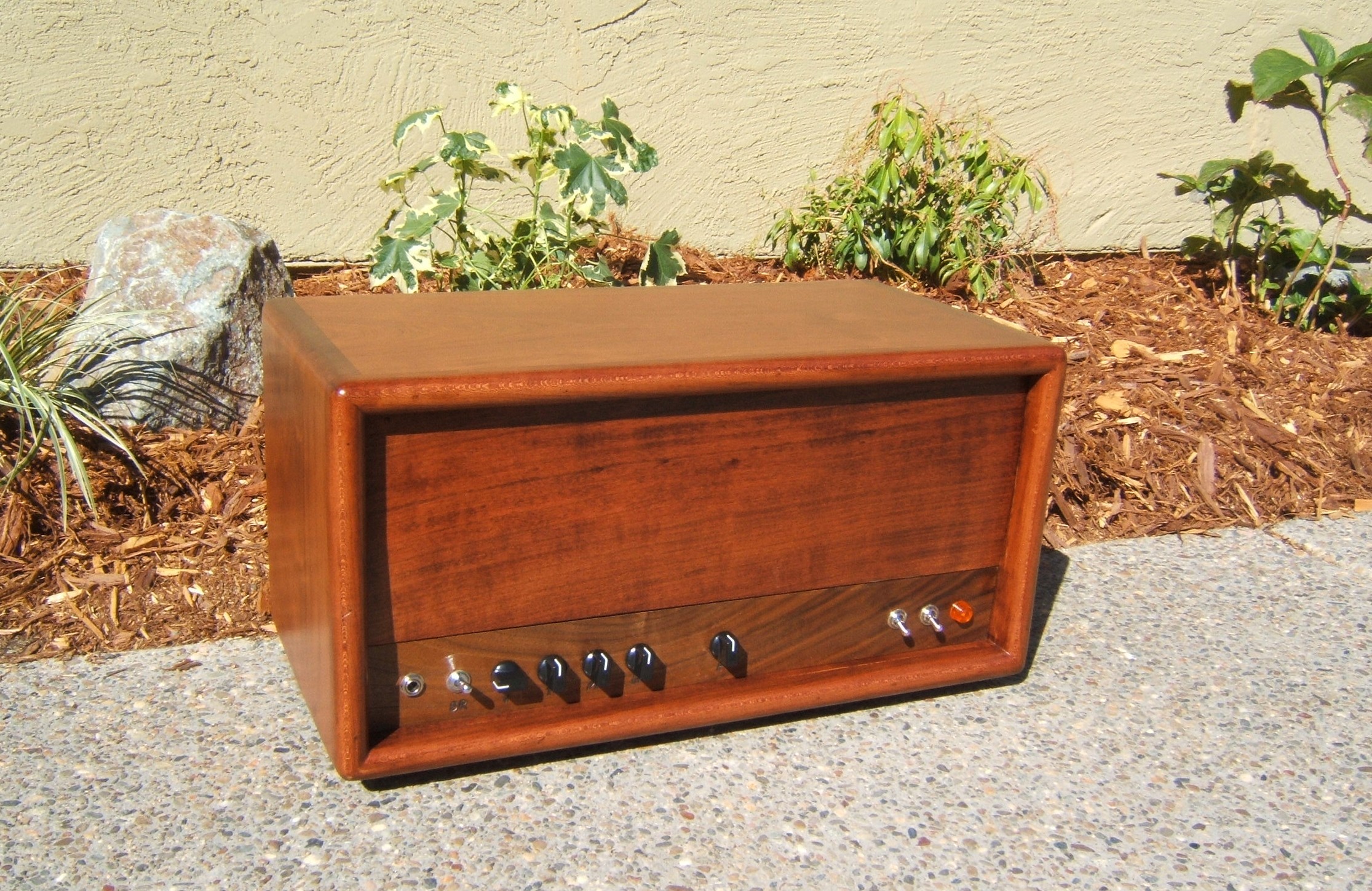

Very nice Paul! Were you taking your amp out on a nature walk?
Re: A new 'pool...
Holy cow! What a beautiful amp!
Any chances of gut shots? Clips?
Beautiful, beautiful, beautiful.

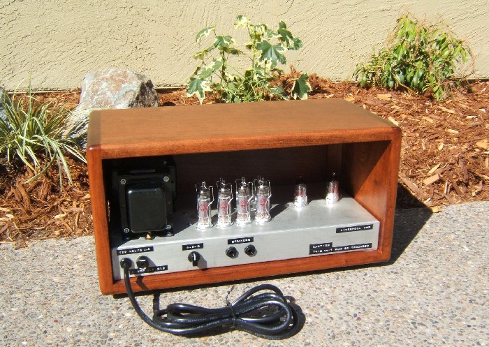

Nothing but all the hardware itself. 1/8" of wood is plenty strong enough that it doesn't need anything else. Same is true for the 1/16" laser etched plastics. On the rear, where there sometimes isn't enough hardware, I sometimes tape and sometimes bolt the plastic to the chassis. You can see two screws on the right side of this one:kec wrote:Paul,
What do you use to fasten the front panel to the chassis? glue? double stick tape?
http://paulamps.com/MartaRear2.jpg

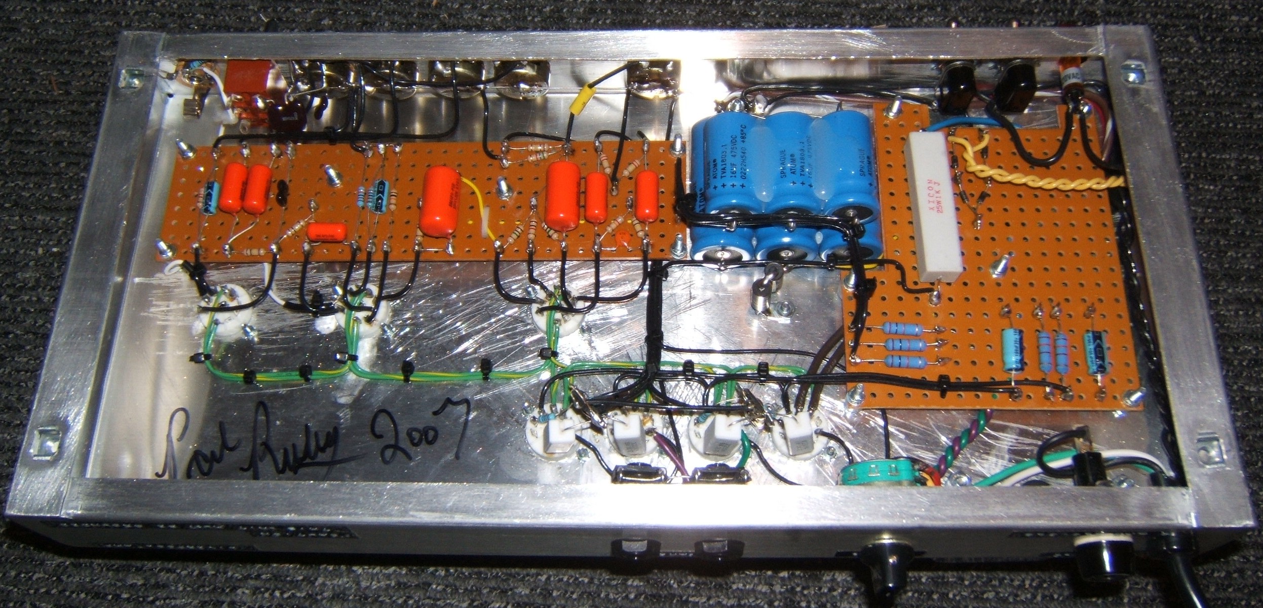

Found a guts pic that I forgot I even took...paulruby wrote:I normally use my own styling and circuit options but, in this case, I was asked to create a replica of a friends amp. The cab is from Bob Burt. Some of the parts to get it just right came from Allyn.

http://paulamps.com/PoolChassisGuts1.jpg
I bent the chassis in my garage myself and then used durafix to "weld" the corners. It's really more like soldering with a torch but works really well.
http://durafix.com/

Great looking amp there Paul - as usual.
And thanks for the Durafix tip - looks like neat stuff
. I thought welding aluminum required a heliarc setup.
