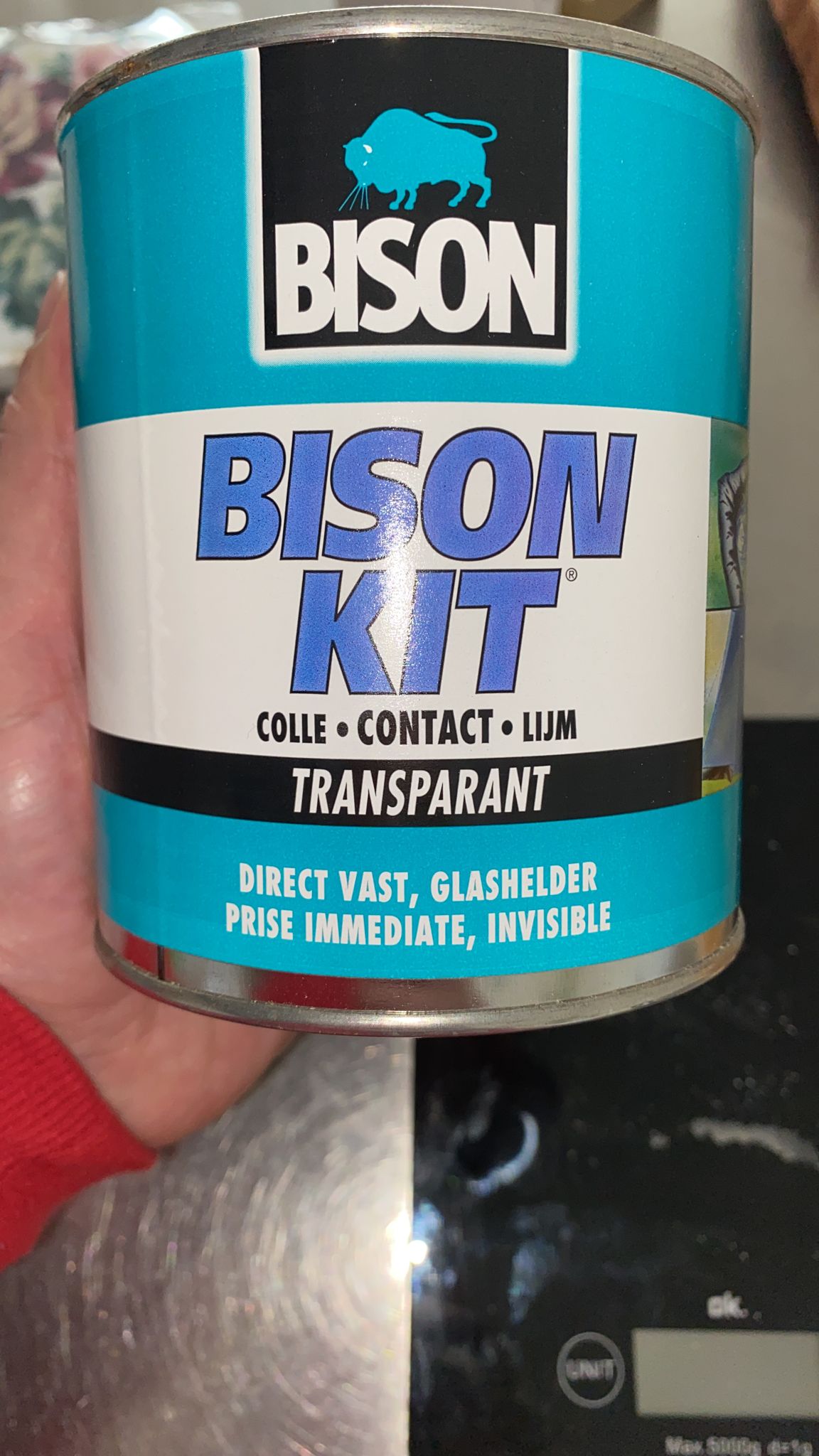

I also right now have Bostick Glue, see photo below, is from Bison brand, it also says that you can glue vinyl and is transparent it smells like typical Bostick I have tried once with Tolex, not with Tweed , and it was a very bad result, unsure if was me that I can't handle it or maybe is just not the right glue, and this one is not water base glue.
