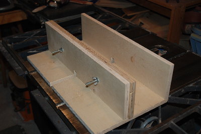

Phil, when you put your sled together, how many boards (and their thickness) did you use to make the front and back rails? And how did you laminate them? I'm a bit concerned about the absolutely flat reference surface and the shear number of clamps (which I don't have) used.
Re: Joining boards
Lou,
I used odds 'n' ends I had around the house that my wife insisted many times I had to take to the dump. I'd encourage you to use what you can find if it fills the bill.
The front and rear fences are made from particle board shelf material that was laminated with wood-look plastic. IIRC, these came out of a bookcase that was discarded, as they were 30" each. This made it very flat and checking with a straight edge, I found it to be very true. I cut 2 pieces for each (1.5" thickness total,) sandpapered the faces to be joined and glued them together. They I had to square them up again with the saw because of extremely minor slippage in alignment. I think I used 4 clamps and it was enough. You can make clamps. Search youtube. Probably the cheapest are the ones made from plastic pipe. Just cut off some short lengths and slice out a bit. Use a bit of brute force to open them and snap them onto your work piece.
You can buy a "ready panel" 2'x4' sheet of MDF, particle board, or plywood* for around $5.
For the runners, I used a piece of maple I had bought for something else and never used. I was so very lucky that the .75" side of the stock was an unbelievable perfect fit in the slot, so I just ripped off a couple of pieces. Remember, you want them shallow enough that they don't touch the bottom of the slot.
I ran the sled back and forth a few times and it rubbed off a bit of black stuff from the slots. A little sanding fixed that. Then a coat of paste wax on the runners and bottom did wonders to reduce friction.
*The biggest problem I've got with the sled is balance. After making the cut, the sled is a fair distance from the front of the table and past the back edge of the table. The weight of the rear fence requires me to keep a hand on the sled to keep it from tipping, which is a bad thing to happen. I want to say the lightest material of plywood, mdf, and particle board is plywood. I will probably replace the front fence as soon as I can because of the balance issue.
You might use an ordinary 2x4 for the rear fence as long as the bottom is true, as you don't want it to apply any pressure to the plywood floor that might warp it. If you use regular lumber, seal the ends to keep it from absorbing the enemy, water. Nothing rides on the fence. AFAIK, its only purpose is the keep the two sides of the plywood floor together after you slice in the kerf.
Both fences are considered sacrificial parts. There is no glue on the bottom, only screws secure them to the plywood floor.

Thanks, Phil. I have two 3" face clamps, four 24" ratcheting bar clamps, a handful of C clamps, and a shitload of cinder blocks :-)
I've been wondering about what might be the optimal depth (front to back) for a sled. Last night, I arrived at 36"; knock off and inch and a half for each fence, plus a half inch for slop, and I am left with with 32.5" of usable cut area. I hadn't thought about falling off the table once the cut is made, but I have three roller stands, so I'll just set one up at the back of the saw to support the sled at the end of the cut.
I actually plan on makeing two sleds, and dedicate one to box joints. I don't see a need for that one to be any more than 12" front to back, but it might wind up being wider, so that I can accommodate 15" wide boards (bass guitar and hifi cabinets) :-)
Re: Joining boards
Mine is done on 24" sq plywood and I was surprised at just how right-sized it turned out. Initially, I was thinking I'd make it much less front to back, maybe 18", but that would have been a disaster, way too small. I did not fully understand (difference between thinking and doing) that front to back usable space is limited by the placement of the blade (d'oh!) and that the first 8-10" inches is useless space you need to have.
Right to left will depend on the size of your table. 36" would be awkwardly wide on my portable job site table saw and 36" front to back would probably be too difficult to manage. If you have an outfeed table, you will need to cut slots for the runners, but it will allow accommodation of a larger sled.
Mostly, I think I'd be concerned about being able to manage the sled comfortably. 36 x 36 strikes me as too large. Remember this is for cross cutting a board. Mine will take a board about 12" wide. Are you really going larger than that? If you do, then you can make a temporary jig for it, maybe one without much of a front fence. As for width, that mostly depends on what you intend to build. For a guitar amp head cab, about 20" is fine in my sled and I think 24" would be OK, too. It is OK to have it hang off the edge. I'm doubtful you need 36" for that. If you are building bed frames, then you'll need to figure out how to hold a ~7' rail for cross cutting and that's a whole different idea, for which you can find a solution on, you guessed it, youtoob.
Part of my issue in sizing the sled is the limit of my physical size. I am just under 5'6" and my sleeve size is 32", so big items quickly get beyond my comfort zone. It's not just size, it's weight too, as my short stature limits my leverage. If you are a larger person, and you have a bigger table (mine is about 22" x 24") then maybe 24" or 30" x 36" is fine for you. I don't think I'd go to 36" x 36". I don't believe bigger is better for this. In the end, you'll have to be the judge.

I have an old Craftsman table saw. In fact, it's so old it's belt drive. But it's in good condition. I measured it today, and I've done a layout drawing for the box joint sled and jig. The cast iron portion of the table is 20" wide x 27" deep, and it has a 10" wide, stamped steel extension wing on each side, making the overall dimensions 40" x 27". I do not have an outfeed table. It looks like, in order to do a 15" long box joint, I will need a bit more than 15" on either side of the pin, plus I've included a generous 2" at each end for clamping the jig to the sled's fence. I plan on making the fences 1.5" thick, and the jig 1" thick. The attached pdf is what I came up with: The sled is 39.5" wide by 16" deep, and the jig is 35.5" long. The center of the saw's arbor is 9" from the back edge of the table, and with a 16" sled, I'll wind up with more of the sled on the table than sled hanging off the table at the end of the cut (16 - 9 - 2.5 = 4.5" hanging off).
EDIT: I will likely build another box joint jig for 3/4" box joints - I think 3/8" would work well for anything under about 8", but getting out toward 15", 3/8" boxes seems a bit tedious.
I haven't done a layout for the crosscut sled yet, but I expect it will be less wide but more deep.

I have no specific advice. In general, I'd make these sleds as small as possible. They get awkward very quickly, both size and weight become factors. Consider the typical board size you'll be cutting and build for that. If you are cutting a 15" wide board for box joints, I'd say you need ~10-12" each side of the pin and you'll have adequate support.
If you want to do a very wide board that is 100% supported, think in terms of flipping the board half way through. For a 15" board, you can divide it 1/3 - 2/3 at the pin. If you have 7.5"" on the already-cut 1/3 side, flip the board when you are half way through.
Re: Joining boards

On the finger joint jig - the third one I made - it has a back flat section 5" or so behind the rear fence. Really helps keep the 30" boards stable. I plan to attach a bit of 2x4" to the rear slot to keep bits from nailing me in the crotch as I cut.

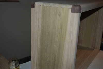

Phil -
You'd asked earlier in the thread about stain. Not a big fan on figured wood as the planks have zones of hardness that resist the penetration so the end result looks blotchy. Guitar guys seal the wood and then apply the stain to the finish to 'colorize' it. To get the grain to pop I use 8-10 tea bags in a 1.5 cups of water to make a Chernobyl strength tea wash. brush it on 3 times - doesn't seem to do much but when you finish my oh my - nice. I used this on a recent poplar cab to balance out the green to the tan.

Hi Phil,
Tea is amazing - here is a before and after pic on the poplar. I dry the 'coats' of tea with a blow dryer. Then I slurry sand 320 let dry and then 400. Oil until the wood 'spits' it back out. Let dry and then polish with 0000 steel wool. Oiled wood is easier to fix than lacquer / epoxy surface finishes.
On something earlier you noted about the wood grain running in different directions. This is why I abandoned routers for rounding edges and why I cut finger joints before I finish mill the stock. Tear out brings tears to my eyes.
Also for the small dings, tears and gaps I use clear devcon epoxy to fill and then finish as normal. Figured wood or contrasting wood joints all of the epoxy disappears.
