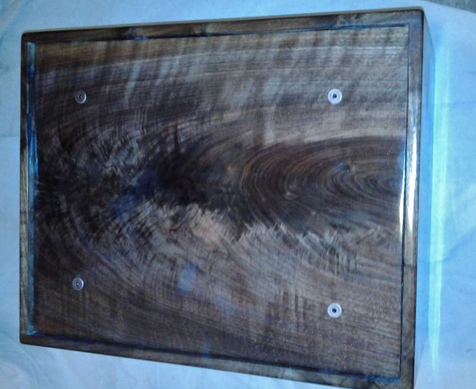

I've been working on my dovetails, and starting to suck at it less.
[img:620:768]http://www.vehicross.info/gallery/data/ ... 231459.jpg[/img]
[img:576:768]http://www.vehicross.info/gallery/data/ ... 231529.jpg[/img]
This is what I mean when I say try to cut you panels in sequence. This makes the grain appear to wrap around the corners. This is getting a Celestion Blue that I bought from Amplified Nation. Not sure what to do for the grill. I may hand weave some cane.

I had a nice piece of claro with feather duster grain for the back, and enough scraps to do amp front and back panels to match.

Matching head case.

Excellent work, and a freaking beautiful piece of wood!
Love that!
Love that!
Cab
Really nice!!!What did you use on the finish,It came out beautiful,I really like the walnut.How does the cab sound.,Great work

Thanks, from you guys that means a lot.
I sand to 600 grit. I use pencil between each grit, if you can sand off the pencil marks, you are ready to go to finer grit.
Finish is 3 steps. First is Watco Danish Oil. This really soaks in. If it only lookd dry as it did wet I'd be done here.
Once that is dry I scuff it with the 600 again, and use Minwax Tung Oil.
I do a few coats of this to build and fill the grain, and sand it back with 600 again.
Depending on humidity it can take a few days to really dry. Once it is totally dry the last step is a coat of Minwax Wipe-On poly.
If you have dust anywhere this will find it. I buff that with car buffer and wax.
Better pictures when i find my memory card. There is a depth and shimmer to this that I'm not capturing at all.

There is so much depth and chatoyance that pictures will never do it justice.. I only know from the star lines I can see in the brighter parts like tiger's eye. So nice!
Love the handle... looks right!

I love it when the grain wraps around a cabinet.

Thanks for sharing you pics John.You do BEAUTIFUL work!!!!!!Thats a keeper for sure,Mikey
