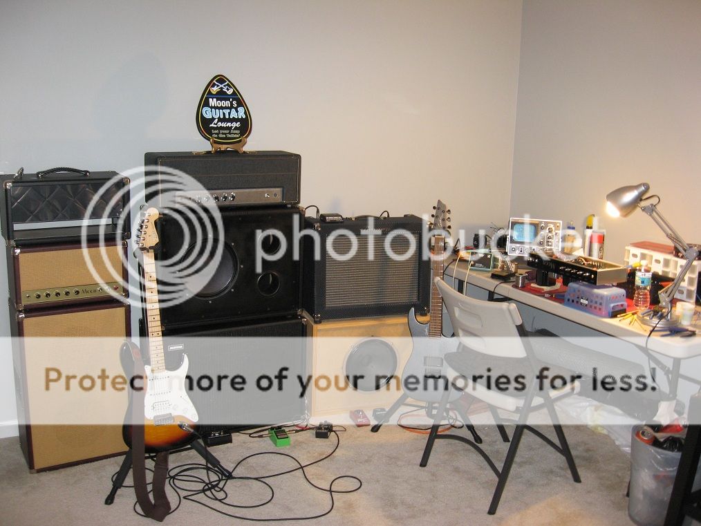

The chassis was a 20 x 6.5 x 2.5 with outward lips from Watts. I always get the matching bottom plate too.
If you use this size chassis in a Marshall-style cab like a Small Box from Mojo, you have to make sure the front panel cut-out is wider than the stock size (I made mine with 19-3/8" wide openings on the front and back.)
This is the head I put it into (top of the middle row of amps):
[img:1014:761]http://i514.photobucket.com/albums/t346 ... room-1.jpg[/img]
