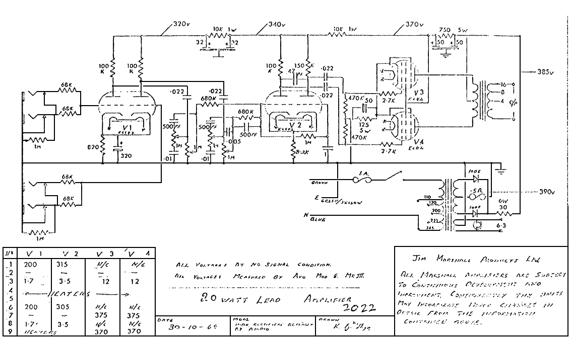

Here is a cure for a dark sounding tone circuit: https://www.drtube.nl/schematics/marshall/2022.gif
I built one of these a couple of years ago, the 2061X version (different phase inverter). The 5nF (0.005 uF) treble bleed cap of the lead channel (middle tone/vol combination) can be very bright. Should tear your head off. I think the 1987 50 watt Marshall had the same value treble bleed cap.
Here's a demo (go to about 4:40 to hear it in action). https://www.youtube.com/watch?v=JAajlPABSHA Amp vol was on 1 for the demo. I suspect tone was max.
