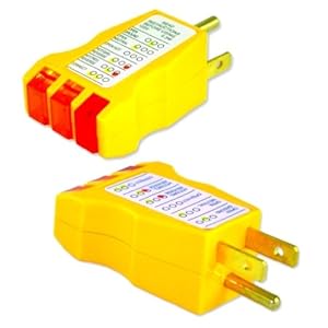

amplifiednation wrote: So this would probably mean one of the outlets could be wrong? can i tell from measuring "hot" to ground?
Yes, you can if you're careful. You want to measure 0Vac between ground and cold, 120Vac between hot and cold, and 120Vac between hot and ground.
If you get any voltage between cold and ground then you might have a poor ground connection in your house that should be explored.
Best thing to start though is to pick up one of these:
[img:300:300]http://ecx.images-amazon.com/images/I/4 ... AA300_.jpg[/img]
from Lowes, Home Depot or somewhere similar and quickly test all your outlets for basic wiring faults.
Every guitar player should have one, especially when playing out.
