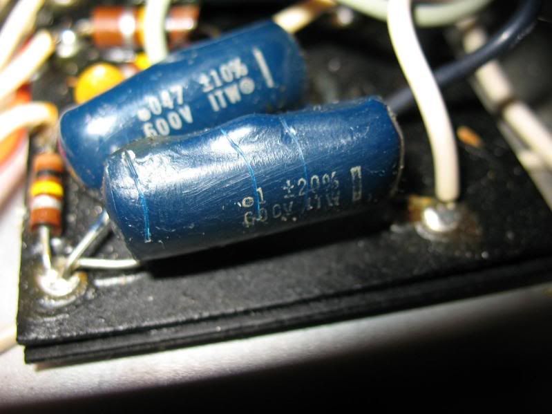

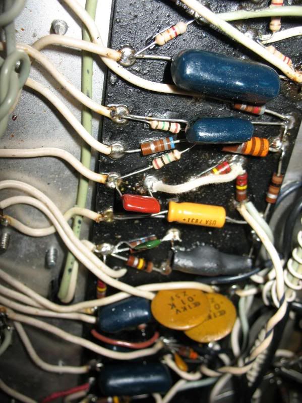

Got a question for the builders/modders here. Im thinking about fiddling with the 3 cap tonestack on my pro reverb on the vibrato channel.
Now it has the .1 , .047 and .047 setup and its those dark blue caps
These:
[IMG:799:599]http://img.photobucket.com/albums/v334/ ... G_8603.jpg[/img]
I'm thinking of trying another configuration and I'd like to know what you amp buiders/modders like. I have read that 3 of the same type(say orange drop) don't sound as good as mixed but that may be internet garbage.
The amp has a lot of bottom end. As it is I run the bass at 2 and the treble at 8. On my other fenders the treble gets ran at 3 or so. The amp is Dark and fat by nature. I like the midrange content and really dont want to add a mid pot or anything or mess with the mid resistor because I've been down that road before and didnt like it.
So basically, which 3 caps would you use and which brands/compositions

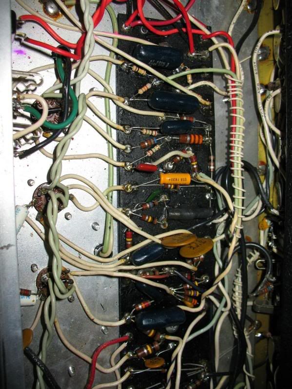

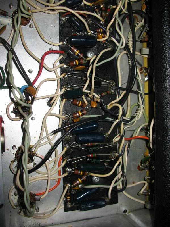

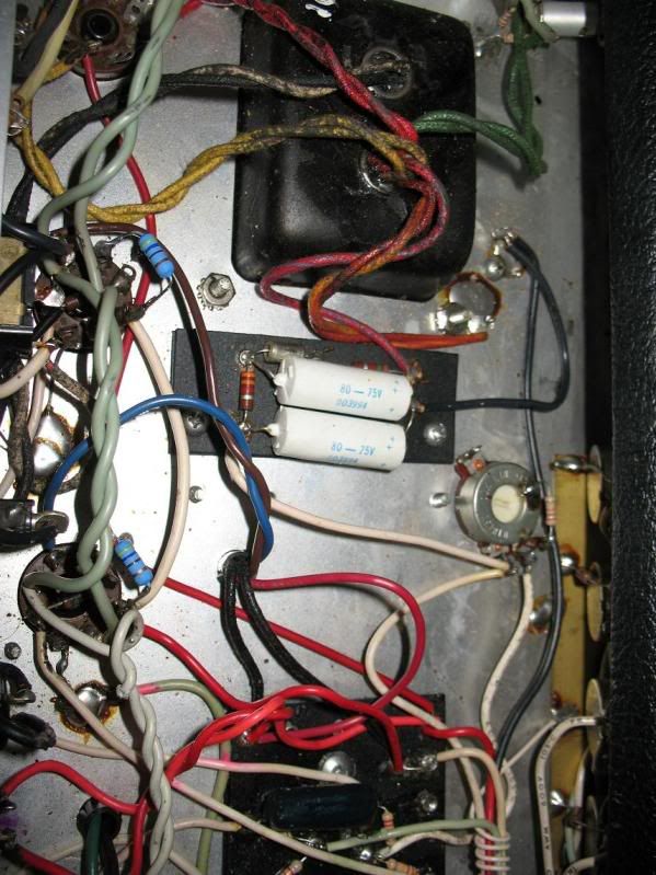

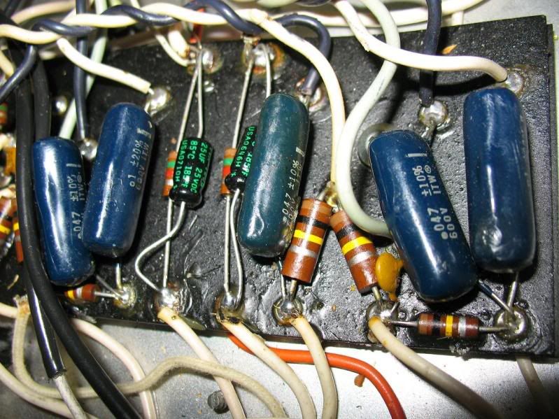

Here's a few more view of the amp so you can see what we are dealing with.

sidehatch wrote:Got a question for the builders/modders here. Im thinking about fiddling with the 3 cap tonestack on my pro reverb on the vibrato channel.
These:
Hi -
First things first: Just to make sure we're all on the same wave length, I'll assume that you know that the picture you posted showing the caps (above) isn't the Trem channel, right? That's the Normal channel we're looking at in that picture.

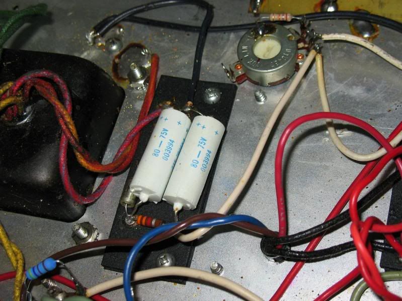

Also, the tone caps aren't .1, .047, and .047. The treble cap is the tiny ceramic disk cap (250pf) at the other end of the 100k resistor. The other blue .047 cap is output coupling cap that runs to the mix resistors on the other end of the board. And that .047 coupling cap is for the Normal channel. The coupling cap for the Trem channel is .02uf.
Here's what I'd suggest as a starting point: Blueprint the original tone stack before you mod it. Meaning, I'd bet that the existing caps were on the outer limits of their manufacturing tolerance when new, and have drifted well away from that by now. Start be replacing all three caps with new caps that you've measured to be sure they're close (if not dead-on) with the original spec. Replace the 100k resistor with a good carbon film (or better) that you've measured to be closest to spec.
Getting the tone stack working at its designed parameters, you MIGHT find that it doesn't need to altered at all. But get it 'right' before you go shooting off in another direction.
Just my $.02 :D

Thanks for the reply and advice. Yes, I know thats tjhe normal channel in the 1st photo. I just took many pics and thats the best one that illustrates the caps Im talking about.
I understand the treble cap is the small 250pf cap. One my super reverb its a Tantalum. I wonder if its been replaced?
On my super reverb it has a .1 and a .022 and a .047 and the pro has (2) .047's which I guess maybe works with the 12" speaker better?
I am just getting into working on amps myself. Got a bias probe and have a cap discharge device( alligater clip system I read about and made)
I definitely don't want to just start replacing things becasue i would hate to loose what I already like about the amp.

First, I apologize that I didn't word my previous post clearly enough... :oops: I'll try again with some visual aids:
sidehatch wrote:I understand the treble cap is the small 250pf cap...
...On my super reverb it has a .1 and a .022 and a .047 and the pro has (2) .047's.
It seems from your typing that you're still confused about what the tone stack actually includes. Below are two images - the top one is from the Pro Reverb schemo, and the one below it is from the Super Reverb schemo.
As you can see, the tone stack consists of the 250pf Treble cap (on both), the 0.1uf Bass cap (on both) and on the Pro, a .047uf Mid cap, and on the Super, a .033uf Mid cap.
Unless it's been modified, your Super doesn't have a .1, a .022 and .047 in the tone stack. Likewise, unless the Pro has been modified, it doesn't have two .047s. And from your photos, it looks like it's still stock.
I think you're mistaking the .047uf coupling caps for being part of the tone stack. The in both of these pictures, you can see the .047 cap at the output of the second gain stage in the upper-right of the picture. They sit relatively close to the tone caps on the board, but they're not part of the tone stack.
[img:274:203]http://www.doctorvintage.com/misc/pro_r ... estack.jpg[/img]
[img:245:173]http://www.doctorvintage.com/misc/super ... estack.jpg[/img]
Now... since we're talking about the coupling caps, that is an area that you can fiddle with very easily on a Fender amp. When you look at the schemos for this style Fender amp, you'll see that the two different channels have different values for the coupling cap in that position. The Normal channel uses a .047uf cap, as shown in those pictures. The Trem channel uses a .02uf cap. You can change those caps around to change what each channels sends on to the PI. Easy. Easy.
I have a Pro myself (well, it USED to be a Pro...). One of the mods I did to the Trem channel is to have TWO different coupling caps - the original .02uf cap, and another which I have switchable, which brings the coupling cap up to roughly the .047uf value of the normal channel. The bigger cap makes a 'bigger' sound. I flip the switch around to 'tune' that channel depending on whether I'm playing humbuckers or single-coils.
GREAT STUFF!
I stand by my original recommendation - blue print the tone stacks (the real tone stacks...)
And add this one - play with the value(s) of the coupling caps following the second gain stage, particularly the .02uf cap on the output of the Trem channel. Big results for very little work...
