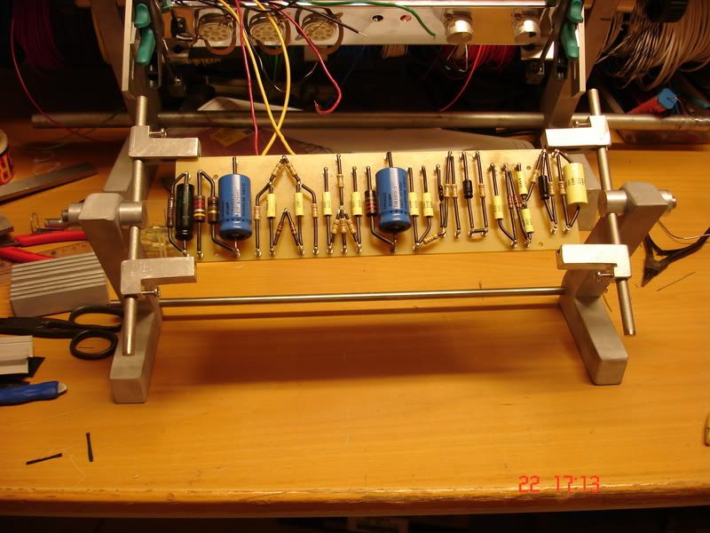

Greg wrote: ... Anyone ever build there own?
I was jealous of those who had one, so I built this one. :oops:
Tim

Re: Chassis Cradle
Tim,
Nice, clean, functional and simple, but I do not recognize the round bottom clamps they seem to be of the same manufacture as the hand clamps. Home Depot or Lowes?

M Fowler wrote: ... I do not recognize the round bottom clamps...
Mark,
I used a WIlton Multi-grip Clamp.
http://www.amazon.com/Wilton-60685-Mult ... B0000AQK8R
I fastened it to the end of the aluminum extrusion which I get from 80/20 Inc.
http://stores.ebay.com/8020-Inc-Garage- ... esstQQtZkm
The clamp has stops around its circumference. I took those out of the right hand clamp so the chassis could be turned with the left clamp only. The 2 ends of the cradle are connected by a 1/2" rod. The length of chassis you can put in it is only limited by the length of the rod. It seems to hold the chassis quite stable.

I am coveting that amp cradle...

dehughes wrote:I am coveting that amp cradle...
It was ridiculously simple to build. Thinking up how I wanted to do it took a little more time, but my brain is a little slow :?

Post by dehughes »
What was the total cost of it?

Post by greiswig »
Nice, flexible design. Good thinking! How is the extrusion fastened to itself on those angles...did you weld it, or are there 45-degree channel connectors or something?

dehughes wrote: ... What was the total cost of it?
The clamps are $25 each on Amazon.com now. I find the quick-grip easy to tighten while maneuvering a chassis. I had thought about making the grip pads wider, but it seems to be very stable as-is. The extrusions probably another $20. The 1/2" rod came from Lowes. The upper arms were one piece with a 45 on each end that I cut in half. It was already drilled for the T-slot attachment to the lower arms. You certainly could weld it, if you had the know-how. The 1.5" extrusions are overkill. It could be done with 1".
These extrusions are the handiest thing since pocket protectors :!: I've built guitar stands, stools, computer tables, and a table for my wife's Big Green Egg. 80/20's ebay site sells the company's overstock and used items. You can get items very economically if you don't mind the wear and tear on the used stuff. It's just a big Erector Set :D
