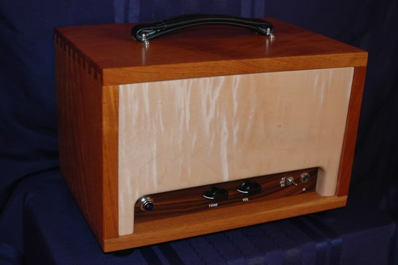

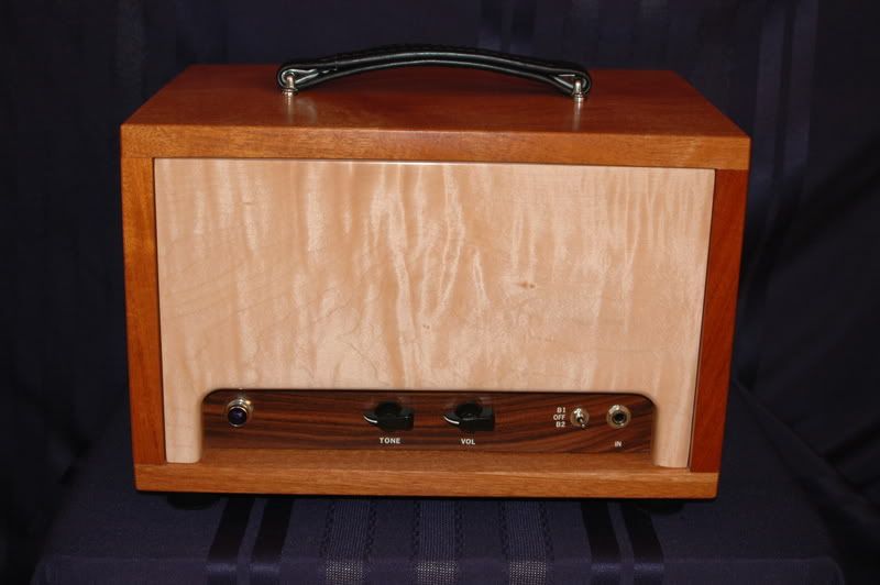

I named the amp the Dirty Dog. It's an SE amp with VVR. It's also my 1st woodworking project. And yes I jumped right into doing dovetails. The cab is Mahogany and Maple with rosewood veneer faceplate. Turned out OK, IMHO...
Here are some pics. Hope to get some clips recorded soon.

Looks great!

Looks professional to me :D I hope she sounds as good as she looks :!:

Looks really good...congrats!

DAaaaannnngggg! :shock: :shock:
I wish my last amp (my 10th) looked anywhere near that good. I usually throw mine in a pine box w/ some expanded steel in front to protect everything. I haven't even gotten to what would be considered my first 'woodworking' project.
That is one nice looking amp. What's the empty octal socket for? 7591 maybe? (try it. you'll like it. All your friends are doing it. You'll be cool if you do.)

The empty slot is for another 6v6. The amp will take one 6l6 (as pictured) or one el34 or one kt66, but it can take two 6v6s or one.
The amp sounds great (ok, maybe I'm biased :) ). Cleans up nice and gets dirty when needed.

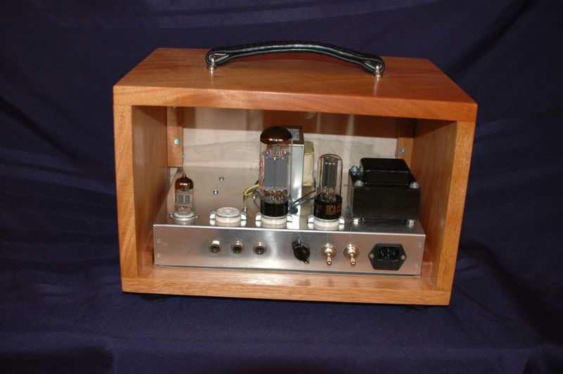

Here you go, the guts...Sorry did not have my brother-in-law's camera gear to take the photo. So image is not as good as the other pix. The amp is based on Dave Hunters two-stroke amp with some minor tweaks and the addition of the VVR. I probably should trim those unused xformer leads...
