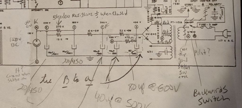

I am trying to rewire the power supply on an old Ampeg G15 that someone disassembled and left abandoned some time ago.

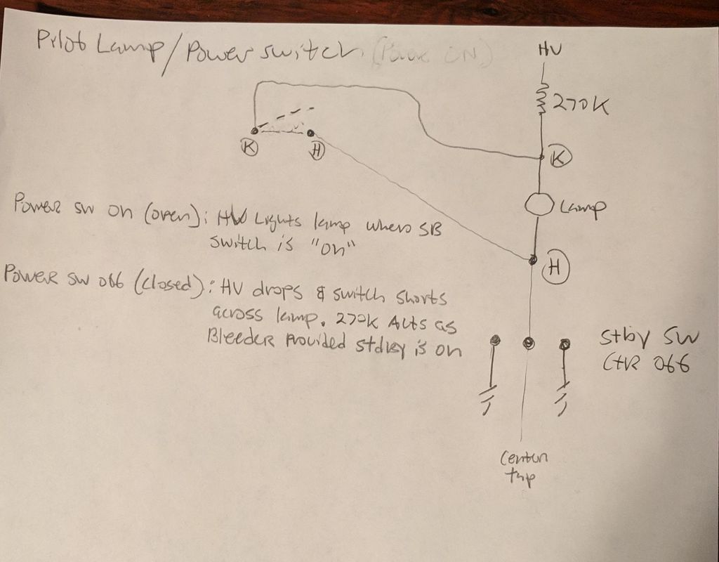

My question is about the way the pilot light was originally wired. Looks like it runs off of DC from the 270K resistor at point "K".
Seems that 1/2 of the power switch was used to short across the pilot lamp to use the 270k resistor as a "bleeder" when the amp power switch was in the off position. Note the poles of the power switch are "backwards" from one another - meaning when the switch that powers the primary with 120V is closed, the other leg of the switch with the indicator is open.
Questions:
Is my hand-drawn "simplified version" correct?
If so, when the standby switch is in the center "off" position, how would the pilot light stay on?
Your drawing is correct. The pilot lamp operates anytime the power switch is on. It is independent of the STBY/POL switch positions because the lamp is connected directly to the PT center tap.
The contacts on the power switch that short across the lamp simply kill the lamp immediately when power is switched off. Without those contacts, the pilot would stay on for a while until the filter caps drained after turning power switch off.
I have the same situation as 65greg. a 66 Ampeg G15 that someone had really messed up the wiring. Having trouble wrapping my head around the solution, mainly as it pertains to the wiring of the hardware. Could someone please indicate the actual wiring hookups by filling in the wiring diagram I"ve attached. (sluckey?) I'm installing a 3 prong cord and want to use the original switches (see pic) but eliminate the polarity function. Is there a way to hook up the DPDT switch so that it only yields the + polarity no matter the position? The amp currently has a purple wire from the pilot light at "K" and a black wire from the pilot light at "H" that each go to the switches.

i hear you, sluckey, but I'm still not sure how the wiring goes. Can you download my wiring diagram and do a layout? Or should I just fill it in myself and post it for approval? I'm mainly confused as to where the purple wire connects and also the center tap (same place?). I was planning on attaching the neutral (white) to the primary at he 1st hole on the eyelet board, and not having it connect to the DPDT at all.
Thanks Steven, but I don't know how the switch is wired. What wires connect to it? and from where they originate. Maybe you could reference my diagram and describe the connections. i apologize for my limited understanding.
