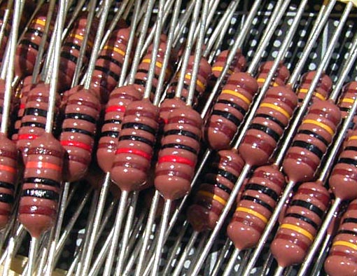

I like these "pillbug" Vishay/Dale, 1w MF resistors:
http://www.vishay.com/docs/31544/packthre.pdf
They're adorable!
[img:510:394]http://image1.shopserve.jp/transmitsoun ... aydale.jpg[/img]

Yeah, I agree, purely from an aesthetic point of view it would be nice to have a sexy looking amp. Key word, nice. I'm not trying to build a show car that I put on display with the hood open. I'm trying to build a high performance muscle car for actually driving. Aesthetics play a role, but I would trade all the sexy in the world for a jaw dropping tone.
Where do you typically get those little bugs? I like how readable they look as well.

They just look funny. :lol:
