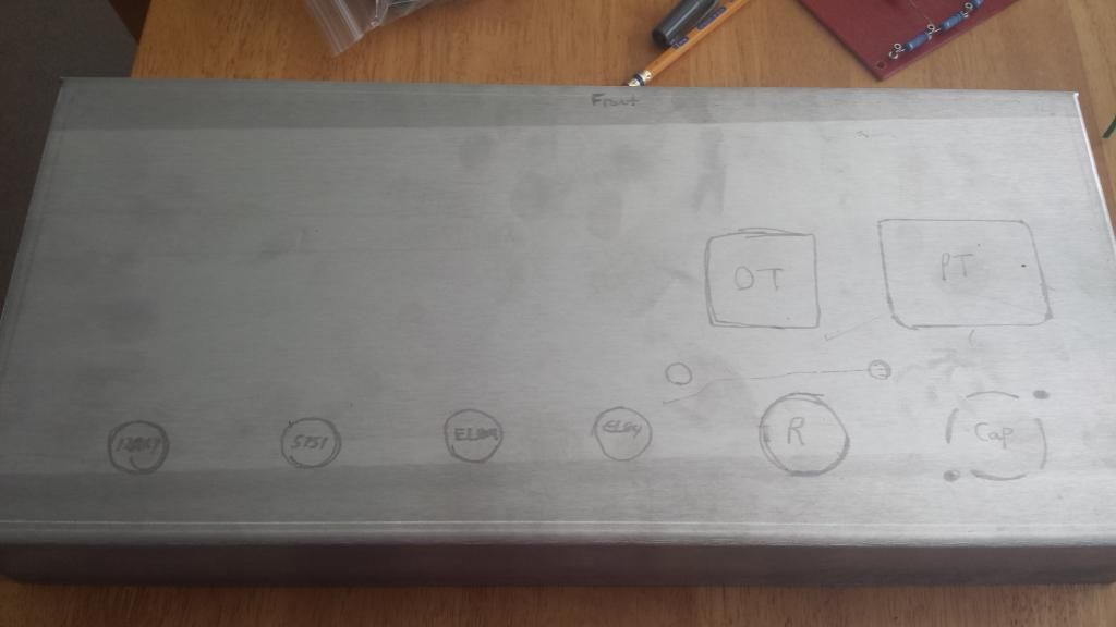

Nice! Couple of word of advice:
--Make sure the tube glass will have enough clearance by the transformers. You may want to move the transformers back a little.
--You've got all the weight on one side. It make it unbalanced to lift. Sometimes I compensate with a weight on the opposite side of the cab.
--Preamps may be a tad closer to the edge than you imagine. Dry fit the board before you drill the holes. Draw the holes on the inside. It can be a bit of a dance to fit the board and the tube holes.

Phil_S wrote:Nice! Couple of word of advice:
Thanks for the advice. I want to keep the power supply as far away from the input as possible. Pretty much all amp chassis are "end heavy". Once it's in its cab with a speaker it won't be as noticeable.

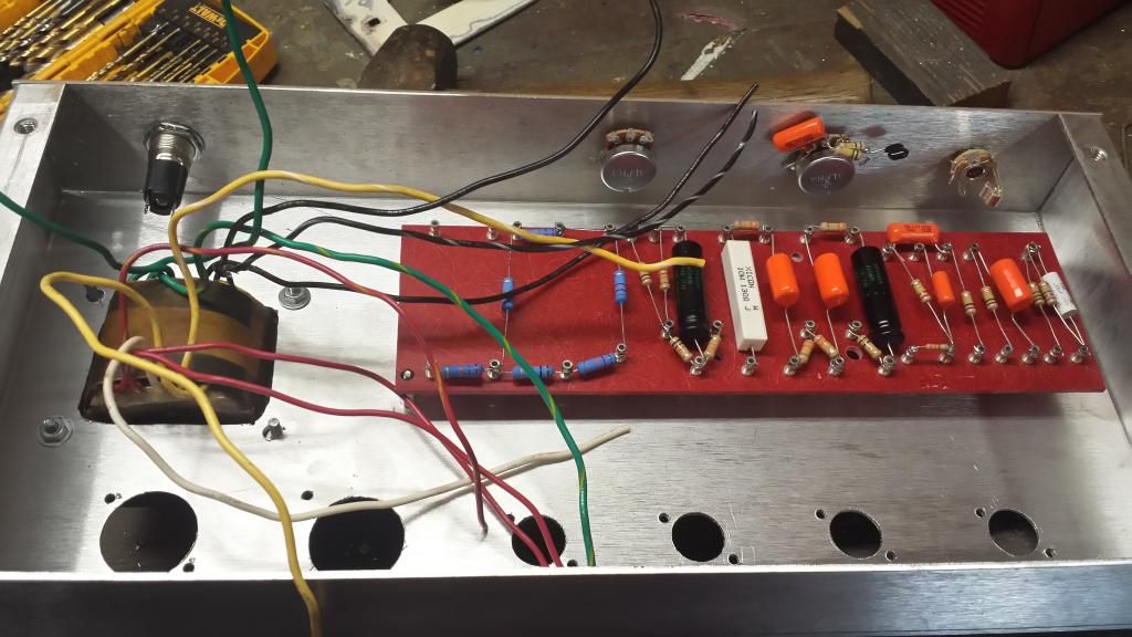

Be sure to check out transformer placement.
I would recommend using the headphone trick to place the OT.

Tell me more about that, Structo. Meanwhile, here's today's progress.
[img:1024:576]http://i272.photobucket.com/albums/jj16 ... 125941.jpg[/img]
[img:1024:576]http://i272.photobucket.com/albums/jj16 ... 49_LLS.jpg[/img]
