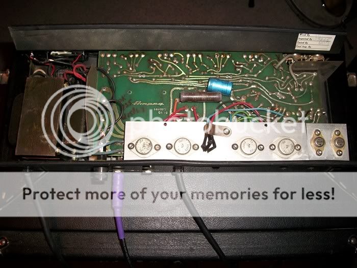

The BT-15's I've seen had a fuse holder wired to the back like this:
[img:700:525]http://i554.photobucket.com/albums/jj40 ... tshot2.jpg[/img]
I suggest that before you work any further with that amp you hook it up to some kind of a current limiter that will limit the fault current to safe levels that no longer create further havoc. (e.g. putting the amp in series with a light bulb is usually a good technique).
After that it's systematic measuring and replacing of bad parts.
