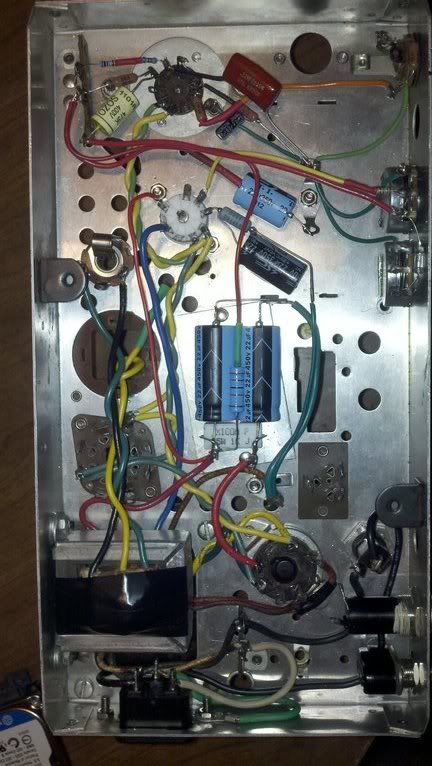

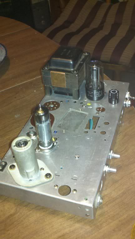

For this category I have to enter my rebuild of a Bogen CHB-14.
OK it wasn't total crap but it was the later flimsy el-cheapo variety.
I put together four of my favorite things.
Pentode preamp with a voxy voicing.
Alternate low loss treb and bass tone controls.
Tweed deluxe style gainstage and inverter
Noval small combo triode/pentodes
All this was done with minimal metal work.
I only changed one pot , with knob. I also had to add a fuse holder with a 3 wire cord.
(Can you believe these things were built with two prong cords and no fuse) ?
All in all it has to be one of my best efforts and making a silk purse of a pig scrotum.
At lower volumes it has that pentode shimmer and higher up it has that tweed compression.
I'm not saying there aren't any bad sounds in there but there are a few good ones if you are patient, I suppose I need to do a little "voicing" too.
All in all not bad for using all the major components and tubes while not using up too much cash and drill bits.
