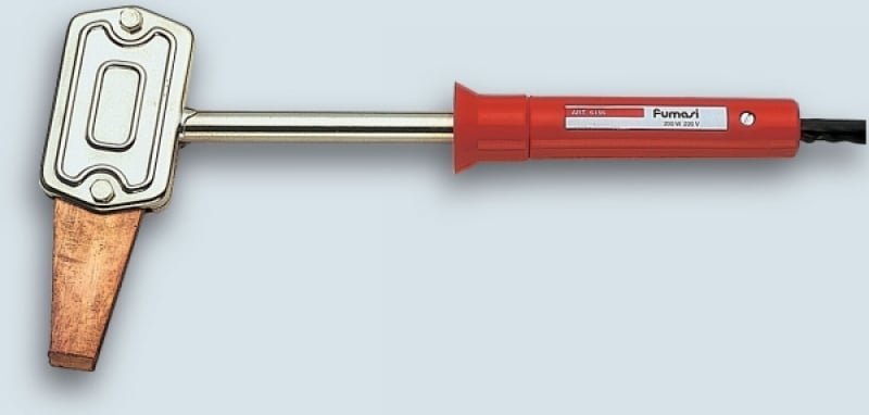

I bought a cheap 150 watt soldering iron with a chisel tip off eBay that was designed for stained glass... it takes a while to heat up, but solder just runs from it even on a steel chassis...

Also I think they used to make tips with a wide area on the end to heat a bigger area.
That would help transfer more heat as well.
