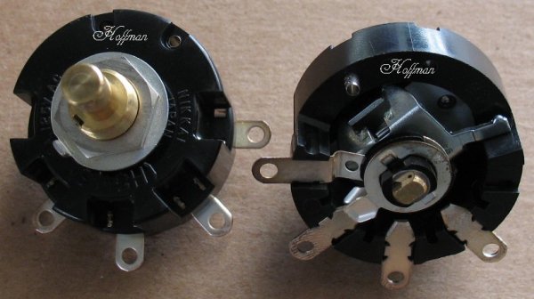

Hi John, I'm not familiar with that impedance switch.
I think most of us use the three position one like this.
Hoffman sells it as well as others but it is a heavy duty switch with wide blade contacts.
[img:600:336]http://www.hoffmanamps.com/MyStore/cata ... G_2266.jpg[/img]
$9.50
http://www.hoffmanamps.com/MyStore/perl ... =506153869

I must've read your mind...I have that same switch now (that's an old pic where the Weber switch was still installed).
