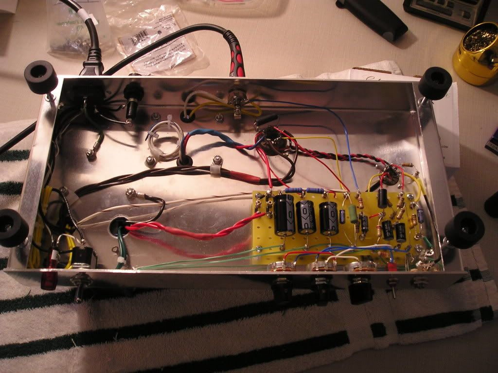

So I finished my Eagle Supre build this week and built my Lightbulb limiter.
So today I decided to fire the amp up and see if I screwed anything up. Well the lightbulb got bright for a split second and then dimmed to a very soft glow.(SUCCESS!!!!!!!!!!!!!!!!!!!!!!!!) I then took voltage readings and things seemed ok, I then plugged the tubes in took more voltage readings and so far so good. I plugged my guitar in and it sounded great not the slightest bit of hum... very quiet.
I went and ate dinner and decided I would check my voltage readings again and post them here to make sure everything was ok.(Dumb Idea) I was checking my votages at the power tube with the tubes removed and while I was checking voltage at pin 3 my probe slipped off the pin and touched pin 2 at the same time :oops: I pulled the probe away... but the 2 pins were arcing, so I quickly turned off the amp,waited till my nerves calmed down and turned the amp back on...everything seemed "OK" I then shut the amp off put my tubes in and thats where the trouble began. The amp has this horrible hum and the power tube got bright orange and the preamp tube seems to be doing nothing. I plugged my guitar in and with the amp hardly turned up the amp has this horrible ratty distortion sound, no clean whats so ever.
Here are my voltage readings without tubes and with tubes. I know I screwed something up...but I don't know what. Hopefully I did'nt smoke my PT or OT. Any help you guys can give me would be very appreciated. I'm so pissed at my self right now I could scream.
Voltages...

I did some research, and I think I will resolder those two pins and see if that fixes the problem. Man, I hope I did'nt fry my Phillips 7581a
[im[IMG:1024:768]http://i443.photobucket.com/albums/qq15 ... ots002.jpg[/img]g][/img]
