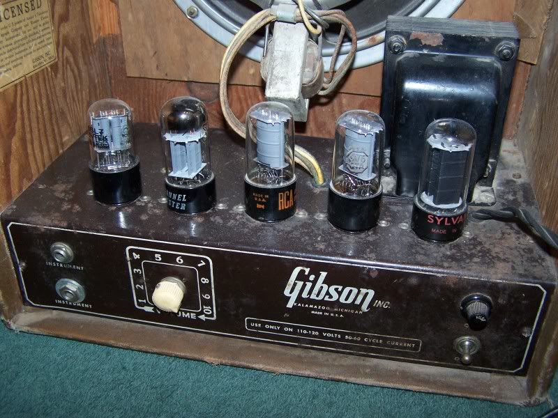

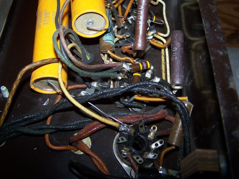

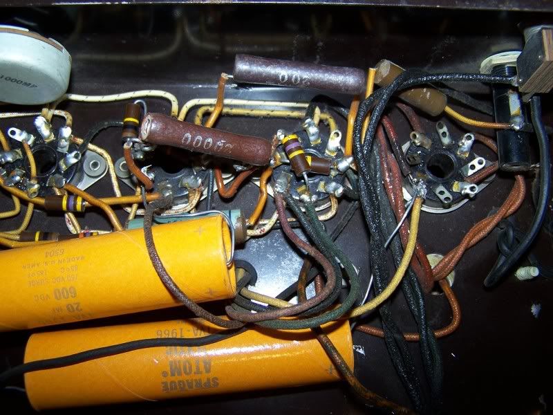

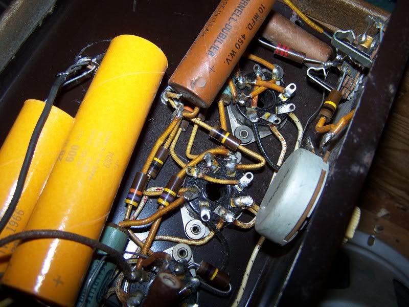

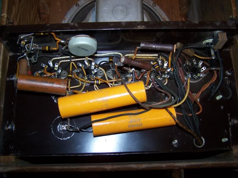

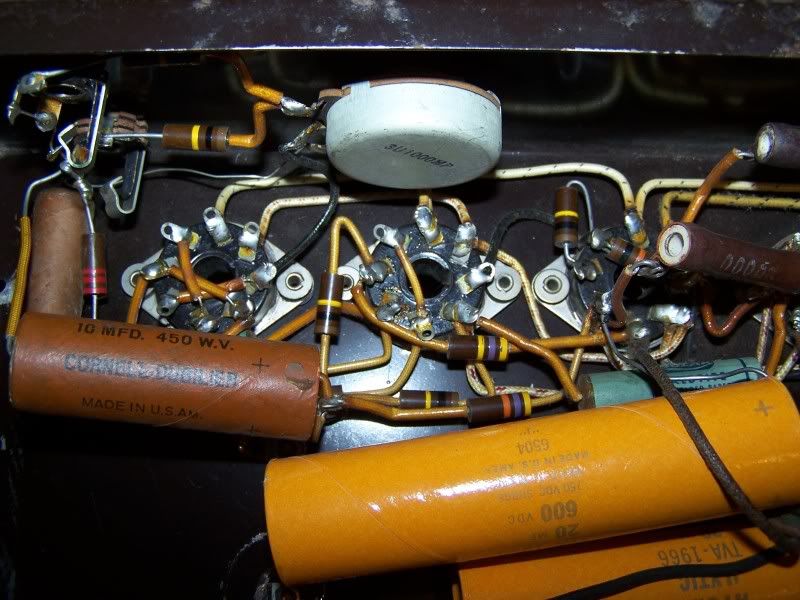

Picked up this cool old Gibson BR-6 a while back. Have no intention of keeping it... plan on selling it. It sounds OK, very little noise (some hum) but it's very quiet. Speaker code is 285652 so I'm guessing 52 week of 1946 as the BR-6 was gone by 1954. Transformer is 138622. No code on the pot that I can find. Appears to be mostly original except for the HUGE Sprague caps and maybe an input jack. Not sure if the pot is original but the solder looks very clean.
Plan on swapping the power cord first thing and probably the Sprague caps.
Any other suggestions? Comments?

I rehabbed a BR-1 about 15 years ago. Very cool amp. More powerful than the one you have but pretty similar in construction. There are two things I'd recommend you pay attention to: some of the wires going to the field coil speaker are at full B+ and probably pretty beat. Be careful of cracks in the insulation and be prepared to replace them --especially near chafing areas. The other thing is to secure the filter caps. They are just kind of hanging loose in there. It isn't pure vintage but cinch them in place with some wire ties.

Filter and coupling caps, 3-prong cord (remove death cap if present), and do it one part at a time, as Gibson amps are not consistent and often don't match their schematics either.

Swapped the power cord, pulled the death cap, swapped the filter caps and the cathode cap on the first tube. Fired it up and it sounds MUCH better. Still a little on the quiet side for a 10 watter but a HUGE improvement. Measured about 1vdc after the first coupling cap so swapped that too.
Working thru this thing it seems to follow the schematic pretty close except for one big difference......the .05 coupling cap from pin 5 of the phase inverter (the plate of the top half of the 6SN7 in the schematic posted above) to the grid of the 6v6 is missing.... :shock: Best I can tell it was never there.....hmmmmm. Am I right in thinking it NEEDS to be there? Would that explain the volume issue?
Deric®
Re: 1947? Gibson BR-6 advice.....
Yes, put in the .05 coupling cap.

i'm not lookin at the print, but if that's not there, it's a big issue. that's one coup cap that is usually leakin dc

But as for the amp posted. That amp is very clean inside. I've seen much worse.

Thanks for the replies guys! I plan on keeping all the parts. I'm trying to replace as little as possible to get it working correctly. That'll pretty much be every cap and the power cord. The original cord is so bad it's cracked and falling apart in several places.
Got a chance to clip that missing cap in last night. Big difference. Sounds pretty good with a decent growl when cranked up - bottom end holds together pretty good too. Got to clean it up - for now just tacked parts in place one at a time with a few clip leads holding it all together. Looks like a mess.... :shock:
