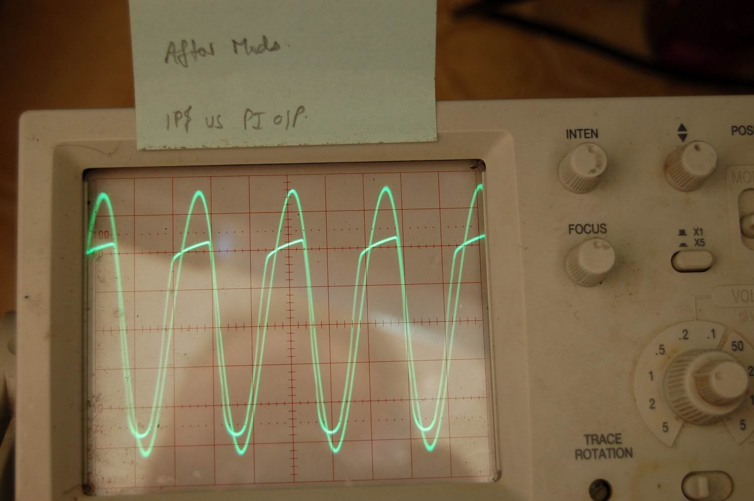

If you're probe is on one of the PI plate resistors, I would expect a trace like this as you increase the volume (here's one I made earlierxtian wrote:Left column: .... As I continue to open the volume pot, PI clip increases, and V2 amplitude drops, and wave becomes flattened.
The sine wave is the input to the PI, and the clipped wave is the output at the anode/plate (the scales have been adjusted to overlay the traces).
What's happening here is that the positive part only of the PI output is being clipped because the voltage is greater than the bias voltage of the output stage - ie. the PI is trying to drive the grid of the power tube positive. There's a fairly abrupt transition from the sine wave to the (almost) flat top when this happens because current starts flowing into the grid and stops the voltage rising any further. (Actually, the coupling cap starts charging up, so the voltage at the PI does rise slowly).
The clipping I see in your traces looks symmetrical, so if these are from the PI plate, it looks to me like it is the PI clipping. Even in the first trace, you can see that the that the PI output is distorted from a true sine wave, which also leads me to believe that your PI is the limiting stage.
