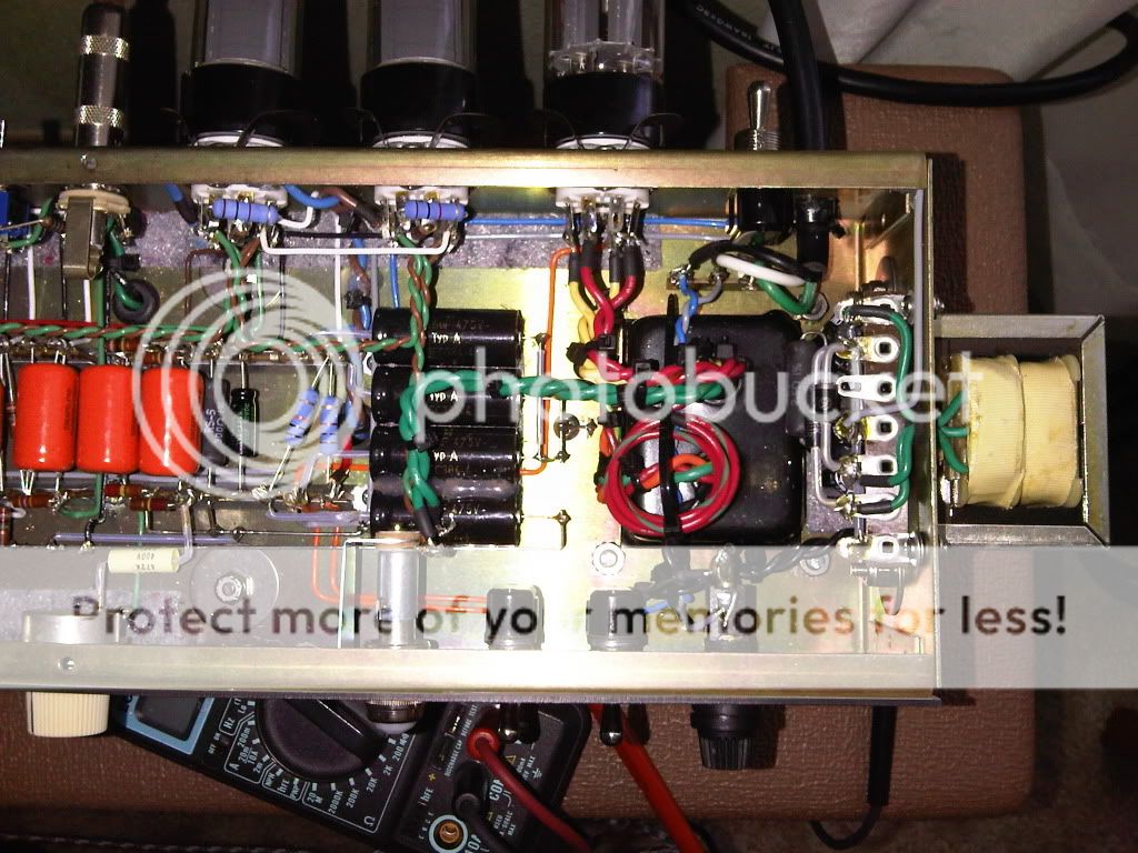

Hmm...I'm kinda wondering if I'd be better served to just buy a different PT that would provide the appropriate voltages, being as Zeners are tough to find, and I'm not sure I'd even have the space for one.
