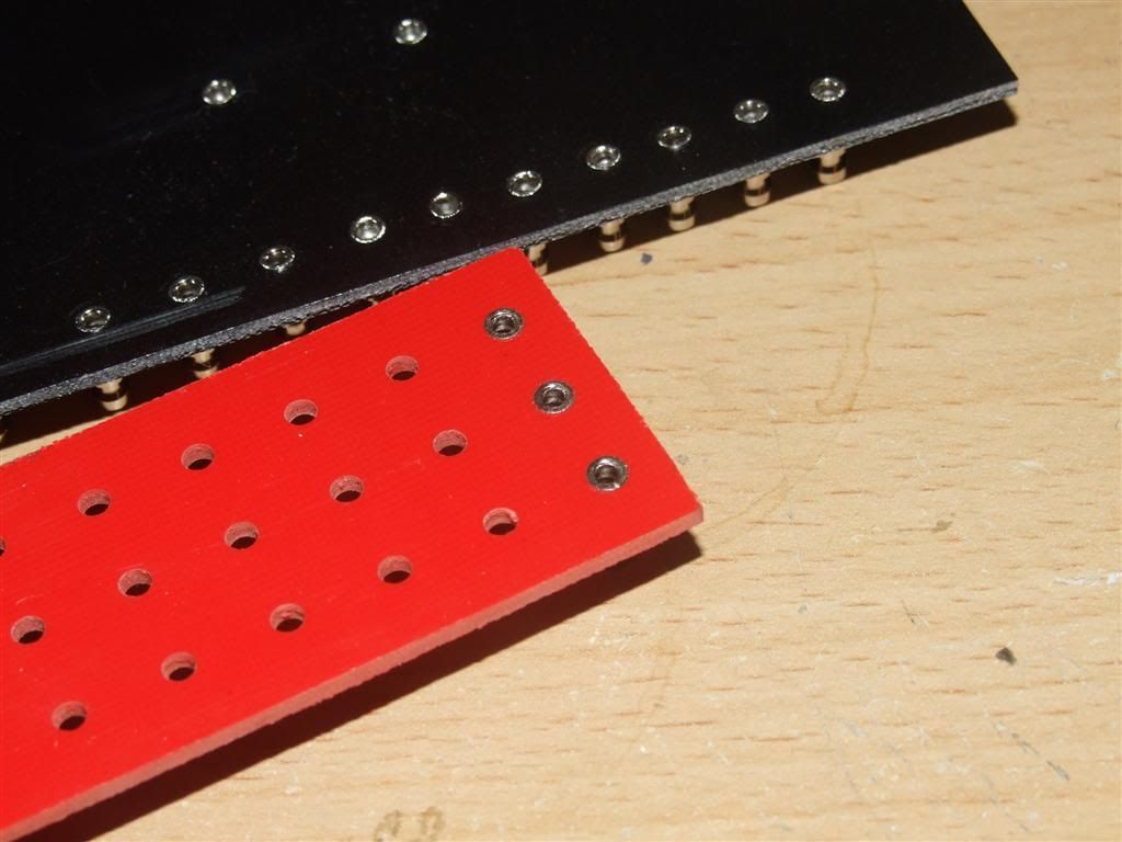

The Chinese turrets use a specific press/install tool, Using a keystone flaring tool will cause them to split. The correct tool slightly flares them over but also compresses the tube into the hole so that it pushes on the side of the hole. Once put in with the correct tool they don’t crack and they are bloody tight in the hole.
You can see the turrets installed with the correct tool in the attached photo:
I also used RS uk made turrets that crack and chip very easily, and are IMHO much worse to work with.
I mostly wrap components around the turrets and have never had an issue wetting, So maybe it’s a solder thing if not a heat thing. Or the inside of the hole is not being washed properly? They are Rohs Compliant… which comes with it’s own struggles

I recently got a supply of small turrets from Mouser that had tarnished look to them, rather than the shiney plated look that Keystone turrets usually have. My larger turrets are from Ken Watts, and all have the shiney look. Point is, solder sticks well to any of the shiney turrets that I use. But, yesterday when I was in the process of wiring a power supply board that had a mix of shiney and tarnished turrets, the solder would not stick without the use of additional flux. My soldering pencil iron is a 30 watt, an gets plenty hot for this application.
I have never looked into it, but I wonder if Keystone is buying some inferior turrets, rather than make them.
Jack

Re: Turrets are a challenge to solder to
I wonder if they are nickel-plated? I bet if you scotch-brite them down to the base metal, they will solder OK. I bet most of us would be happy to pay a little more for silver-plated turrets.
As a ham operator, I have cussed countless nickel-plated coax connectors. They are useless if you can't solder to them....
