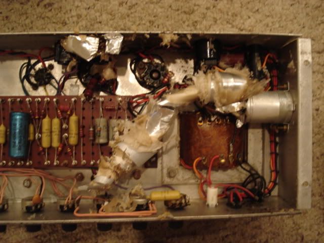

[img:640:480]http://i23.photobucket.com/albums/b392/ ... C01890.jpg[/img]
This was a Marshall amp and it is a cap can that blew up.
Of course that is a worst case scenario.
The guy that owns it said he was aware of it needing to be replaced but decided to postpone it for whatever reason.
He said it sounded like a gun went off!
Not really, but different amps i've seen much worse, Multi section Oil caps, yikes !!
plus coupling caps like the one used as the death cap,those can make a huge mess, some of what you see there in that pic,just not as much, along with a bunch of black smoke residue. I don't know if i still have it,but i used to keep those,just to show people. You look at it, and think no way that little cap made that much of a mess.
