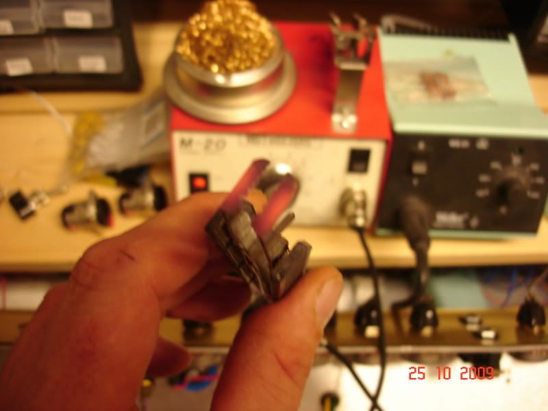

LOUDthud wrote:A thermal stripper works best on teflon wire. The best one is:
The best or one of the best thing you can use on teflon is the meisei HOTwesers. An engineer i work whit bought one at work, he had try ed several different types and the meisei is in his opinion the best. Got mine of e-bay very nice to work whit.
[IMG:800:600]http://i141.photobucket.com/albums/r63/ ... lde019.jpg[/img]
