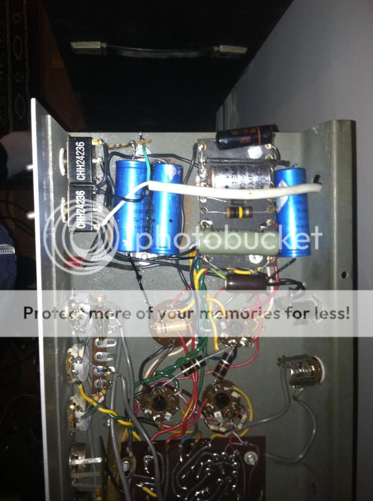

Here is a gut shot of the G150, from which you can make out most of the wires and figure out what they are... hope this helps.
[img:764:1024]http://i885.photobucket.com/albums/ac56 ... dbada8.jpg[/img]
Re: Stancor transformer
The only way to know for sure which leads are what is to plug the thing in and test. This is a very simple test, and it should be safe. I suggested the screw down terminals so you aren't dealing with flying leads getting out of control.
My take on it is:
Primary: Black-Black
HV Secondary: Red-Red/Yellow-Red
6.3V: Green-Green/Yellow-Green
5V: Yellow-Yellow
I don't think there is a bias tap on this one. That's not to say I'm right about that. It's an educated guess.
You are measuring AC volts.
On the HV Secondary, you should see the full amount Red to Red, and half that Red to Red/Yellow. If that is what you see, then Red/Yellow is the center tap. If it is more like 50V to one Red and lots more to the other then it is a bias tap.
I don't like that the green on the Green/Yellow doesn't match color-wise. It may be nothing at all. The check for the CT is same as above. 3.5V to the CT and about 7V across the two Greens. (Unloaded voltage will be higher than 6.3V.) If you have no continuity on the Green/Yellow, it could be a bias tap. Then I'd check it to each Red wire.
There is every good reason to lengthen these wires. I make a splice and cover with heat shrink. Use the right gauge of wire and make the extensions longer than you imagine you want them. This way, you won't be forced to cut off more of the original to get a good do-over splice.
I wish I could see more in that picture posted by Jazbo. The reds are more or less lost for me.
