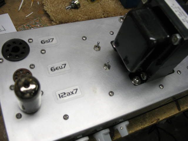

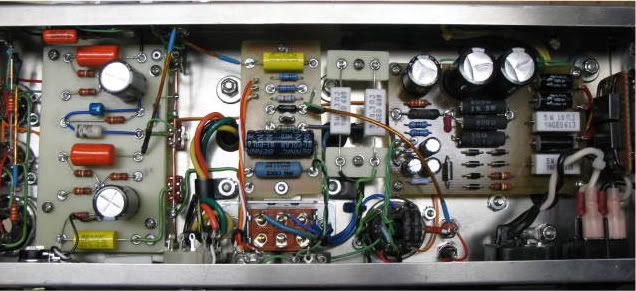

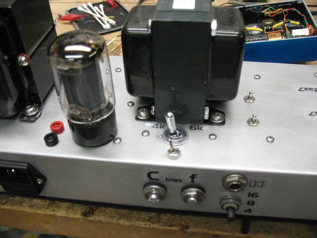

In the spring built something similar to what you described, a 5F2a based amp to use as a tube auditioner. Used a Hammond 270EX and a Doberman (Heyboer) 20watt OT. Put in parallel preamp sockets so i'm able to sample 12a?7's, 6eu7 and 6S?7's or have run with a couple of those paralleled. Can be biased variable cathode or fixed so can run any octal I've got on hand. Switched 4k/6k primary on the OT. Rectified with diodes. Switched caps on the first triode cathode, a switched 1uF cap on the second triode cathode to get lots of crunch. Switched adjustable NFB. Also put in a master volume but it just stays up all the way all the time. A VVR or some other power scaling would be a better option but i can't see anyplace to shoehorn it into the chassis. All in all a fun little double duty amp! :)
http://dobermanamps.com/?pg=transformers
[IMG:640:480]http://i216.photobucket.com/albums/cc30 ... G_0953.jpg[/img] [IMG:640:480]http://i216.photobucket.com/albums/cc30 ... G_0954.jpg[/img] [IMG:640:480]http://i216.photobucket.com/albums/cc30 ... G_0828.jpg[/img]
