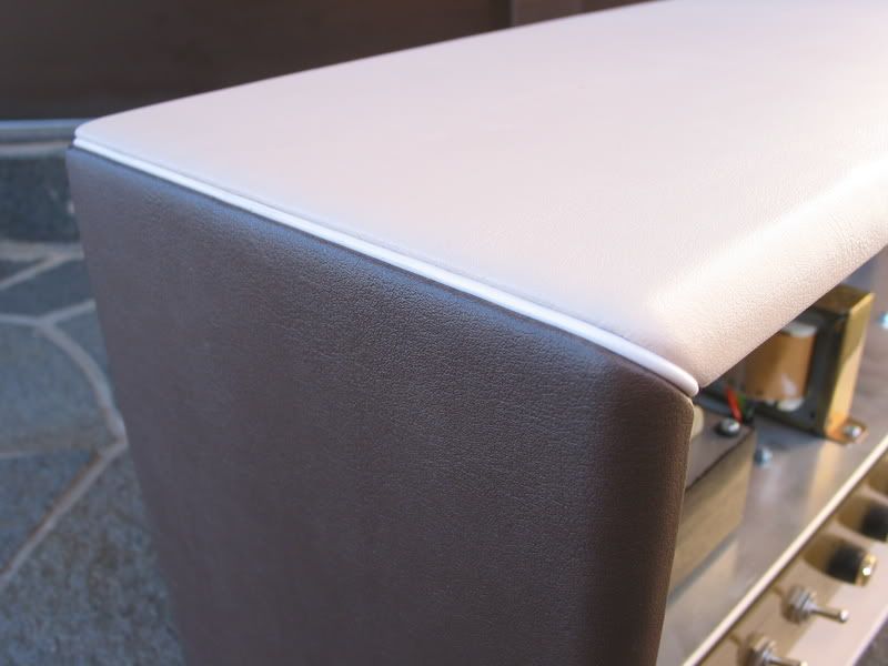

Lot of good info guys. And just for something a little different....
In the future, for a challenge you might want to try doing corners like I do them..ala Komet. They take a while to get down but are sure attractive and draw a lot of positive attention. My amps certainly fall into the "must be babied" category though.
http://i142.photobucket.com/albums/r107 ... G_6608.jpg

Chris

thats fantastic....... hadn't seen that yet
Now thats pipping and tolex in a channel cut into the cabinet?
on the corner like that, does it compromise the strength of the cabinet?
lazymaryamps

Pretty sweet piping work.

Thanks for the compliments.
Yes, the channels are cut at 45 degrees. Cutting these mitres in 18mm box jointed material poses little compromise in structural integrity. I wouldn't be as confident with thinner stock though.

candh wrote:Lot of good info guys. And just for something a little different....
Chris
Nice work Chris! What's your technique for cutting the kerf all the way around the miter to the front of the cab? You can't possibly do that freehand on the tablesaw, right? Is the channel/kerf made before the cabs are assembled? I'd love to do one using your technique. TIA, Noel.
