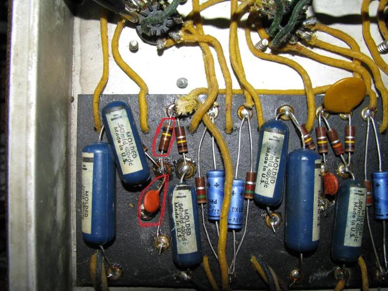

I was taking measurements of the plate resistors and I found one that was overload and pulled it out and it crumbled in my hands. I found another 100K and put it in and fired it up and it did the same thing. I tried taking a measurement of the resistor I just place and it was like a meg or something???? How can I check if the cap is short?
Could the bypass cap be short and fried the first resistor? Heres a pic of the resistor that was fried and I replaced along with its bypass cap.
[IMG:800:600]http://i46.photobucket.com/albums/f144/ ... 1paint.jpg[/img]

War Admiral wrote:I was taking measurements of the plate resistors and I found one that was overload and pulled it out and it crumbled in my hands. I found another 100K and put it in and fired it up and it did the same thing. I tried taking a measurement of the resistor I just place and it was like a meg or something???? How can I check if the cap is short?
Those Mallory coupling caps will almost never go bad. Even if they did, the problem would be downstream of those plate resistors. Get some known-good 100Ks (1-watts would be best) and replace the all the plate resistors. The one that crumbled HAD to be making a lot of noise.

Thanks for putting up with me guys. I got assbackwards for a while but got on the right track. There was another plate resistor in the preamp section with a hairline fracture because it read fine but he was the badass.
New powersockets, powersupply caps, 2 plate resistors, 2 coupling caps and she's like new!
