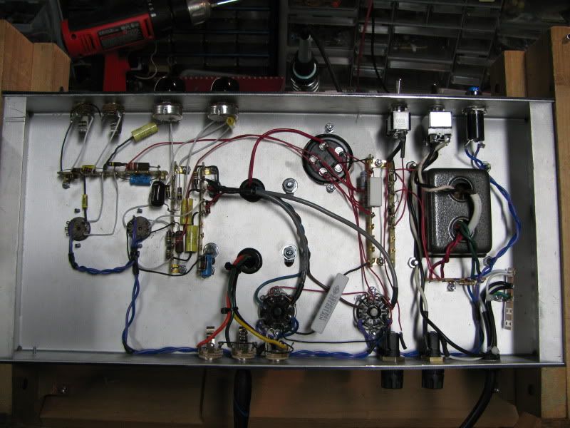

Re: Supro Thunderbolt Clone
I like your build a lot. I also just finished a Thunderbolt build. I built the later solid state rectified version. I used a Hotrod Deluxe PT and a JTM45 OT. I found with modern tubes that a 220ohm or 250ohm cathode resistor yielded about 90% plate dissipation on the power tubes. I also added a pair of 100ohm screen resistors.

I am totally pleased with the amp. I use it for both guitar and bass (its original design intent) through a EV TL-606 cabinet. It really sounds great.
+1 on the screens and higher cathode resistor. That's exactly what I did in mine too.jon wrote:I like your build a lot. I also just finished a Thunderbolt build. I built the later solid state rectified version. I used a Hotrod Deluxe PT and a JTM45 OT. I found with modern tubes that a 220ohm or 250ohm cathode resistor yielded about 90% plate dissipation on the power tubes. I also added a pair of 100ohm screen resistors.
Thanks Jon, it's a simple design and I like the point to point you executed as well. You made it look ....simple and in the case of the thunderbolt, simple works very well. I'm still running the 200 ohm cathode because of the tubes I'm using (a pair of Mesa STR 6L6GC's). Compared to a regular 6L6GC they're huge and their taking it in stride. Now that it's working properly I may unparallel the preamp triode to see what my gain does. It's a tad too much at full throttle. +2 on the 100 ohm screen resistors as well. Thanks for sharing your porn.
