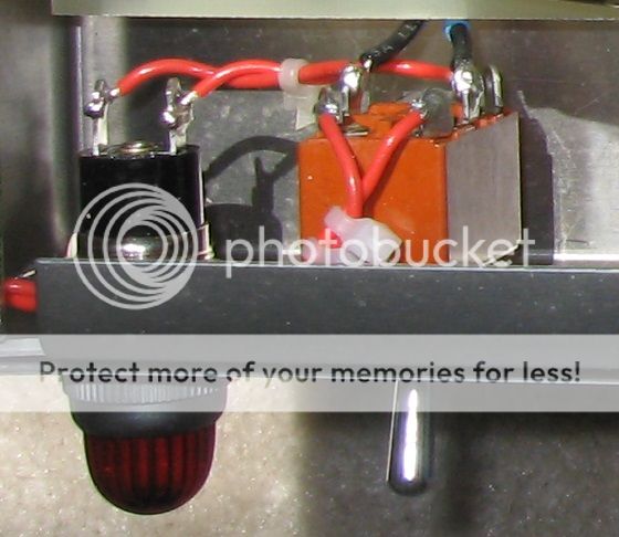

There are several good LED equivalents, in both 6V and 120V. I like to use this 125V socket, which fits in the same hole as the open-style fender socket, and uses the same screw-in jewels:
https://www.tubesandmore.com/products/P-L110
If you use the 120V LED, it can make wiring from the power switch much easier and neater than using the heater wires, depending on your chassis layout. Here is an example:
[img:560:486]http://i514.photobucket.com/albums/t346 ... 20lamp.jpg[/img]
I get mine at superbright LEDs. I like the ones with 4 little LEDs best, and you can mix and match LED and jewel colors to get some cool looks:
https://www.superbrightleds.com/search/ ... 9s%20base/
edit: The pic shows a slightly different socket, but it still shows how you can wire a 120V led pilot lamp directly off the power switch.
