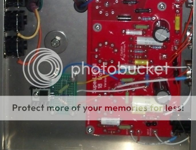

Here's a pic that shows the difficulty in modding PCB circuits - this is a popular 18 watt PCB, with an FET source follower added.
I had to solder the wires on the legs of other components, and be very quick with the soldering iron.
If you build it and find a component is the wrong value, it's tough to remove and re-solder the component.
The best way (IMO) to handle this with PCBs is to use ribbon cables, molex strips, or other removeable wire harnesses, to allow the whole PCB to be flipped for servicing.
[img:684:523]http://i514.photobucket.com/albums/t346 ... attPCB.jpg[/img]

It seems like the red wire is the connection between the plate of the driving triode and the source follower, including a stopper.
The white wire is the B+ taken from the dropping resistor of the first two stages' node.
The blue wire is the signal going to the tonestack, but I can't understand why the ground wire goes to the gainpot grounding point.
The TO220 has a thermal resistance, junction to ambient, around 60 C/W.
Supposing 70 C inside the chassis, we have around 80 C before the maximum allowed temperature (even if I would stay way below).
Let's consider 100 C as a limit, we'll have half a watt as a limit.
With a B+ around 250 V and a source voltage around half that value, we'll have a limit of 4 mA before the need of an heat sink, that it's quite alot.

I like to use those little heatsinks as a way to mount any TO-220 device. It just holds it nicely in place. It doesn't get hot at all. (The gate stopper is 220R and the source-to-ground resistor is 100K.)matt h wrote:Out of curiosity, why did you bother heatsinking the source follower? Did you bias it extra crazy-hot or something?
I grounded the source follower to the pot because it was easy to solder it to the pot's solder lug, even though it made the ground wire a little long.
This PCB uses a signal ground, and a chassis ground which is connected at one point to the chassis, so I wanted to ground the SF to the signal ground, and not just to the nearest chassis ground.
