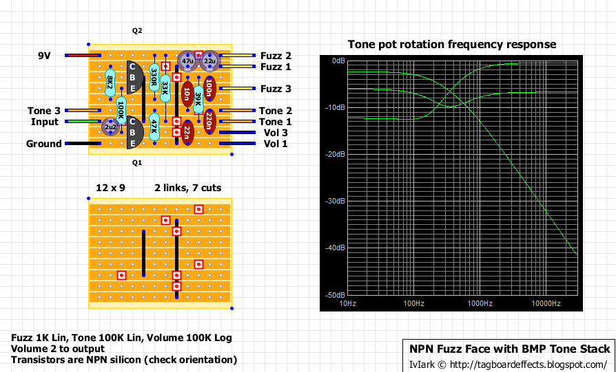

I am now trying to breadboard this one: http://2.bp.blogspot.com/-nxOwK7bE-lA/U ... +Stack.png
But it is a little harder than it looks. I guess it is time to just plug it in and see of it works. I swear, in the time it takes to figure out the breadboard for these perfboards you can do the drilling and just build it as you see it. Once again, I would love to see more breadboarded projects. The Beavis Projects site is the only one I know of that has many examples, and breadboarding is a major benefit in customizing these circuits.
Anytime someone makes a working breadboard design, I encourage you to Fritz it and post the picture someplace (maybe here).
[img:894:541]http://2.bp.blogspot.com/-nxOwK7bE-lA/U ... +Stack.png[/img]

Just got the fuzz above built. Turned out to be a bear until I decided to try sockets for the transistors. Now that it is done, I don't think fuzz tones are the right sound for me (I have heard better ones that this one, though).
I have built some really nice boosts from a Klone to a Brian May. I will take the 1 transistor Brian May over the Klone with 3 ICs, three diodes and an LED. The Brian May has maybe ten components but it sounds so clean and crunchy - really drives a tube amp..
I also built a Tom Scholz-style mockman (op-amp. no diodes) - which has a sweet sustain but is a little too dark and lacking in attack for me. Then I just built a fuzz with two silicon NPN transistors. This one is my least favorite, it is fuzzy almost like a synth, but with no attack on the notes.
(wow, these pedals are so loud just pushing my 30 watt amp on the clean channel my ears are ringing right now, I need to be careful).
