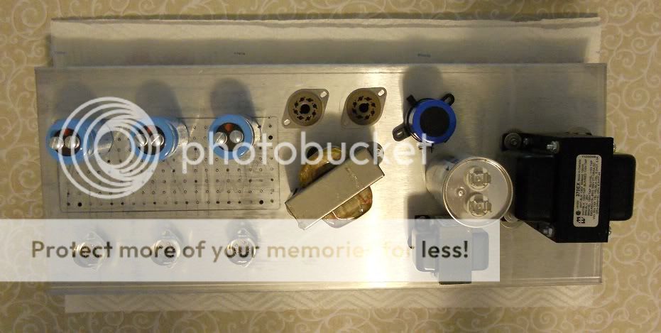

You'll see a lot of amps built by really good builders that have the PT right at one end, and the OT in about the middle of the chassis, so that's a pretty tried and true setup.
Sometimes I end up with the OT being at a 45 degree angle, and I just go with that, even though keeping it at a 90 degree angle looks neater.
Hiwatt and some others have the trannies at the far ends, but as you've noticed, that requires some creative wiring and can increase line noise coupled through the OT.
Laydown or toroidal PTs can help because they are in the Z plane to the OT.
When I want super low noise, like in a recording amp, the final step for me is to use a separate heater transformer.
Here's a pic of the tranny layout of my latest amp, using a Hammond heater tranny:

Good feedback Ken. I'm now thinking... the original PT in this amp was a top-mounted transformer... i wonder if it was a lay down? When they replaced the original transformer with the 125P1A that's in there now, they sawed a big knarly hole through the chassis for the bottom bell to drop through. I wonder if going back to a period-correct PT would help here?Ken Moon wrote:You'll see a lot of amps built by really good builders that have the PT right at one end, and the OT in about the middle of the chassis, so that's a pretty tried and true setup.
