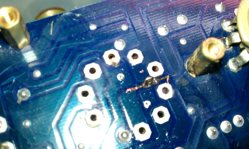

I opened it up and found some burns at the effects loop socket so I desoldered and removed the socket. I found this underneath:

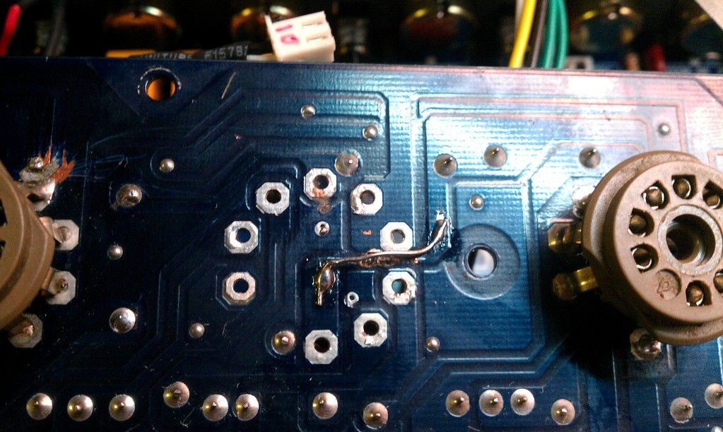

it's a blown up portion of the circuit board and its obviously an open circuit now. so I repaired it like this:

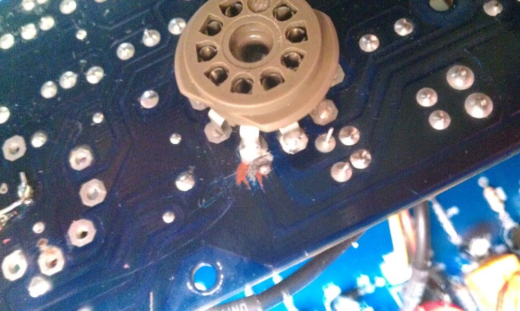

There is also this damage at the phase inverter socket
I don't believe there should be contact between those circuits, so maybe I should just insulate it with something. not sure what to use there though.

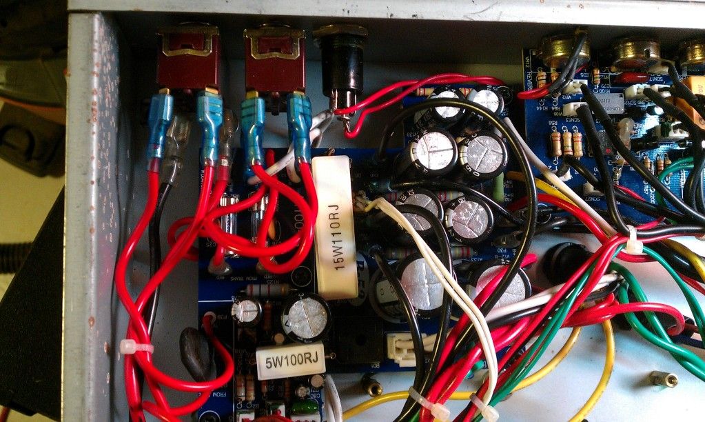

I also found a leaking capacitor and open 3w resistor on the power supply circuit board. I replaced the resistor and all the large capacitors on that board.
After doing all this the Amp works and sounded great for a few plays. but now I am starting to get that popping occasionally that is duplicated when I move the effects loop tube. The damaged traces on the circuit board are the B+ circuits. I may just need to insulate the traces again as I must have some arcing there still.
