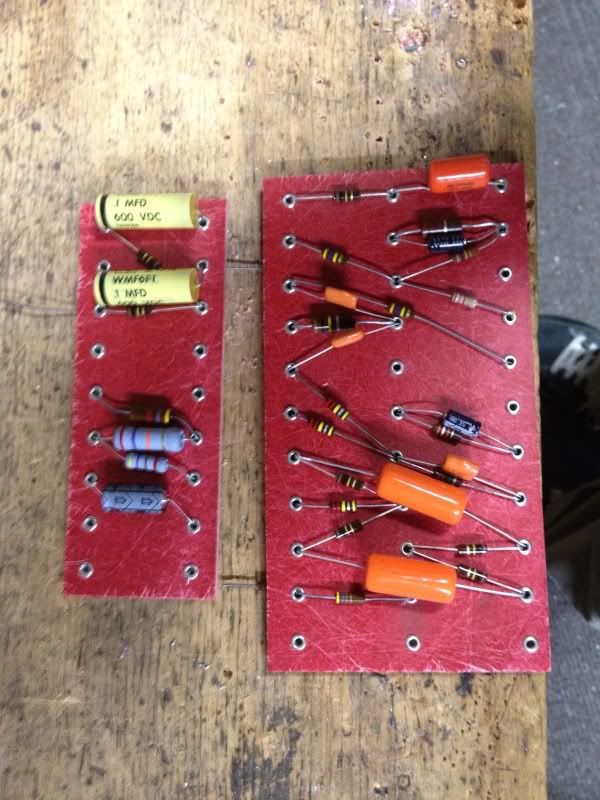

Re: Gibson GA-100 Information
Here are my GA-100 Boards. I'm gonna replace the orange drops with CD150's and I am going to change the power supply resistors. I did goof a little and I added too many eyelets on each board. I'll fix that tonight.
