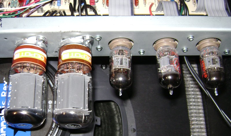

Seeing a picture of someone else's blues junior with 5881 tubes:
[img:800:471]http://www.duhvoodooman.com/miscimages/ ... 5881s].jpg[/img]
It just seems closer than I ever otherwise see!

Just want to be sure about sticking two octal tubes so close together.... I might stick with El34s, as they are a good deal narrower than 6L6 tubes...

The octal tubes have more than enough clearance from each other in that picture. I'd be more concerned about distance to the speaker magnet. I can't see what it is, but it also looks OK.
You are probably limited to octal tubes in straight bottles. Coke bottle shaped glass probably won't fit.
