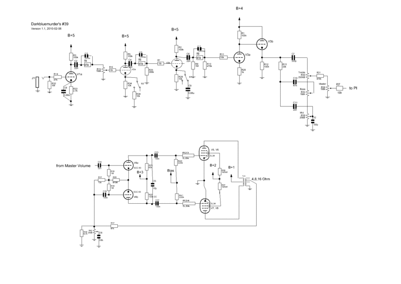

John_P_WI wrote:Nigel and Gldtp99,
I did not follow the link too closely but it looks very similar to Kevin O'Connor's 4 stage high gain marshall mod from TUT. Roccafortes HG100 amps follow a very similar design. KOC maintains the low input between the 2nd and 3rd stage for clean tones.
Instant Zakk Wilde pinch harmonics if that is what you want. If you dump some of the high freqs across the plate resistors and a cap to ground after the master volume you can get the Splawn tones easily.
My guess is the 10k on the input cathode helps limit the noise which would be amplified all the way through.
Hi John, thanks for the info on that mod.
Here is that schem in better quality
http://img707.imageshack.us/img707/8835/dbm39v11.gif
Cheers
Nigel

gldtp99 wrote:I worked from this schematic made by DBM:
[IMG:800:566]http://i46.photobucket.com/albums/f112/ ... FD-DBM.gif[/img]
The amp started life as a Laney AOR 50 made in 1987--- i gutted the PCB and built a 50 watt (turret board) version of a Krankenstein from the schematic online--- it sounded much like a real 100 watt Krankenstein owned by the former studio engineer across the hall--- but it wasn't my cup of tea so i made some changes (changed plate-driven tonestack to cathode follower driven and some value changes)---i still wasn't all that happy with the amp's tone.
Then i found DBM's #39 schematic online and re-did the preamp along those lines----- but keeping the much higher power supply filtering values from the Krankenstein-type design. The Krankenstein power supply also doesn't use a choke, so it's been removed. I'm too tired now to trace out the amp but here are gut pics:
http://s46.photobucket.com/albums/f112/ ... AFD%20Mod/
This amp is running a nice pair of RFT EL34's---- V1:RFT ecc83--- V2: JJ ecc83s---V3: Mazda (England) ecc83----PI:EI 12ax7.
This one has a Resonance control between Treb and Mid pots (was the Sweep control in the Krankenstein circuit)---- and it has a "Power Dampening"-type 2nd MV instead of a Lar/Mar PPIMV.
It's not all that pretty inside after being built as three different types of circuits----- but it works well and has a thicker/fatter tone than the #34-type, 3 stage amps IMO.
If anyone would like me to go through the amp and identify the values on the preamp tubes like i did on the other amps ----- just let me know and i will------ otherwise the pics and DBM's schematic should provide enough info to get what's going on with this one........................gldtp99
I'm curious as to B4 & B5 voltages on this build. THANKS!
Give me a few days and i'll have this info----- i won't be able to work in my shop until at least Thursday..................gldtp99

rocketeer wrote:Thanks man. I'm also interested to see how filtered/stiff you had the PS in the preamp sections. Just curious! Thanks again.
Filtering:
EL34 Plates--- 135uF
Screens------ 135uF
PI, V3, V2, V1-- 16uF each
Voltages:
EL34 Plates-- 413V
Screens-- 395V
V4a--329 V4b--327
V3-- 292V
V2-- 248
V1a-- 225V V1b--237V
