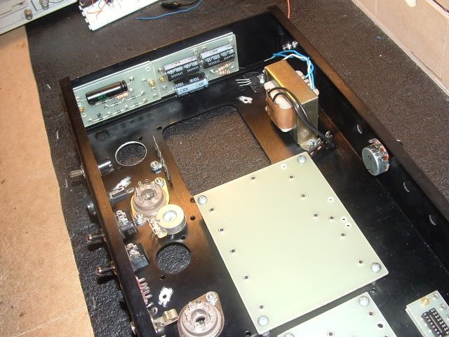

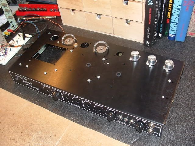

Working on a 50W #124 ODS. I am going to update this thread as I build, try and get feedback on how I am doing.
So far I have gotten the chassis and almost all the parts needed for the build. Still waiting on pots, wire, OT, PT and a few other random things.
I did a bunch of chassis work and got most of the parts mounted.
[IMG:640:480]http://img.photobucket.com/albums/v610/ ... ingTop.jpg[/img]
[IMG:640:480]http://img.photobucket.com/albums/v610/ ... eneral.jpg[/img]
[IMG:640:480]http://img.photobucket.com/albums/v610/ ... ingEnd.jpg[/img]
[IMG:640:480]http://img.photobucket.com/albums/v610/ ... ngBack.jpg[/img]

It looks like you have your power supply board mounted backwards. That chassis is punched in the back for one of the big XLR round jacks. They're pretty expensive, like $24ea. or so.
