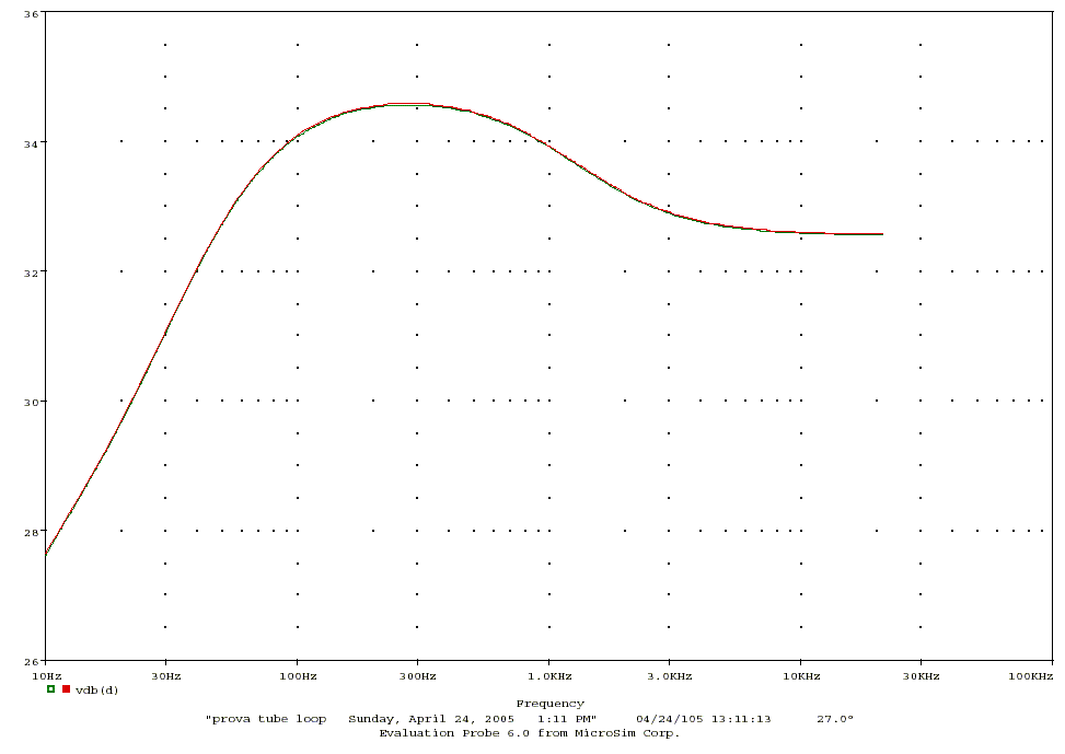

I've hacked the Dumbleator into SPICE simulating software and run a freq response. Guess what?! It boosts the lows!

I suppose the dotted curve is the one with the D-lator, right?

no the d-lator is the solid line! (the dotted line is the phase angle)
I went to the same results years ago, you can still get it from my site:
http://www.m-elli.it/dumbleator_freq_resp.pdf
Timo
Does anyone have a gif or jpeg image of this file? Thanks,

Post by llemtt »

Thanks!!!
