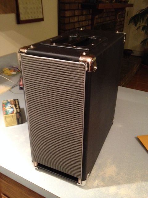

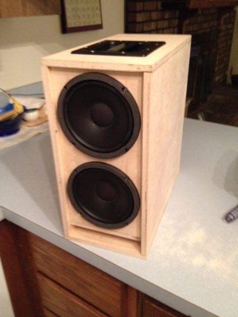

Hope this isn't to far off topic. I built a couple of Dumble #102's with the info here and what great amps! It took about three years (oh well) but very pleased with the result...except...wow, I'm getting too old to haul around all this heavy stuff. My buddy who got one of the Dumbles for the price of two empty cabs from Sourmash and two sets of tubes bet that I couldn't get a pair of six inch speakers to get that 12" speaker sound. He suggested the bass end would just be, well, lacking. Enter this...
I built this with some Beyma 6B30/P's:
[img:480:640]http://i855.photobucket.com/albums/ab11 ... 1c2bc0.jpg[/img]
[img:480:640]http://i855.photobucket.com/albums/ab11 ... 673fd6.jpg[/img]
from here:
http://www.talkbass.com/forum/f15/nano- ... ld-978212/
The Beyma's should get to about 60Hz, maybe a little higher with the cab, maybe 70Hz, and the 4mm max should be able to push about as much air as a Jensen 12", or that was the thought. On paper, it should work.
WOW! Great sound and less than 20 lbs to carry. We'll see how it holds out at practice but definite full range tone and great OD sound with the Dumble. Pretty loud too and nothing shredded yet. A little tweaking to version B but I am very happy with the sound and the volume.

Try the link for all the details on the cab. I used the Beyma 6B30/P speakers (~$58/ea):
http://www.beyma.com/uploads/ftp/Fichas ... 002436.pdf
The only things I would change, make the cab just a little wider and taller, maybe 1/2" or 3/4". That way, you can fit a 1/2" post in on either side of the speakers for the grill frame. I had to carve mine out and it made the frame too weak. I also mounted the back on with screws instead of glue. This required 1/2" stock on the inside to screw the back screws in. Really, the hard part was the speaker holes which my buddy did with a router.
