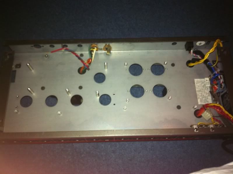

I got a peavey triump120 and I'm using for a two rock build but as you can see in the pics the preamp tube would be right under the board. Would that create a issue or would it be fine?

Not a problem. I do that in my Angelsbreath and SSS builds.
Looks like a cost effective approach to getting a decent chassis and iron. Have fun!

You can have your board over the sockets but lead dress is difficult like that.
Re: Ideas to solve a chasiss problem
If it's only one tube you have to have under the main board, make it the reverb driver (only 3 leads and one of them direct from the transformer).

You negleted to also say that you probably cut holes in the boards to drop the wires dewn to the sockets. At least that is what Alexander did on the real ones.jelle wrote:Not a problem. I do that in my Angelsbreath and SSS builds.
