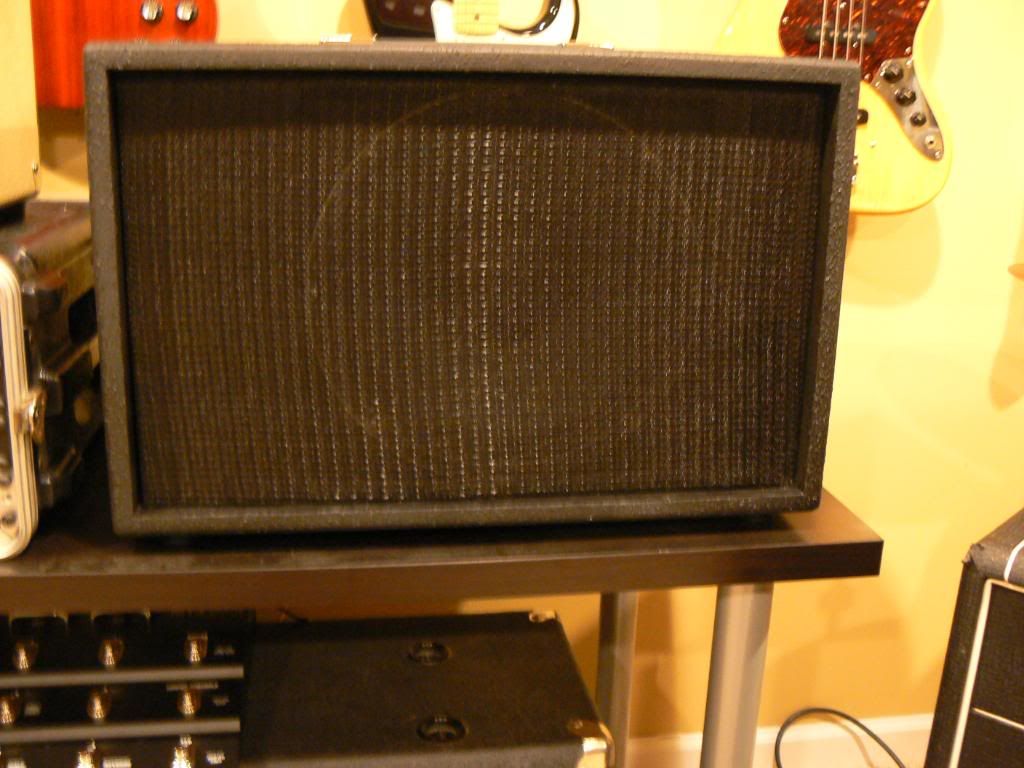

Here's a pic of the finshed cab. I tried out the Herculiner stuff since Pep Boys had it on sale. I only used one coat of the stuff...I thought the texture would be too aggressive. I sprayed a second coat with the non textured stuff. I'm pissed at the crooked grill cloth. :evil: but, oh well.
The ipod was full with the complete Booker T & the MG's discogrophy, so I patched it in to the input of my Lab L5 and turned it up and left for the day to break in my speaker. I sure hope some of that Memphis soul found it's way in there 8) Seriously, it does sound great. I've tried it with my 50W non HRM amp, and it definitly brings something different to the game vs my 4X10 combo. Not really better per se, I mean I still dig the 4x10 closed back combo with the Emi Legends, it's just hard to describe. Obviously it's got better punch, but the clarity is diiferent as well. I like it 8)

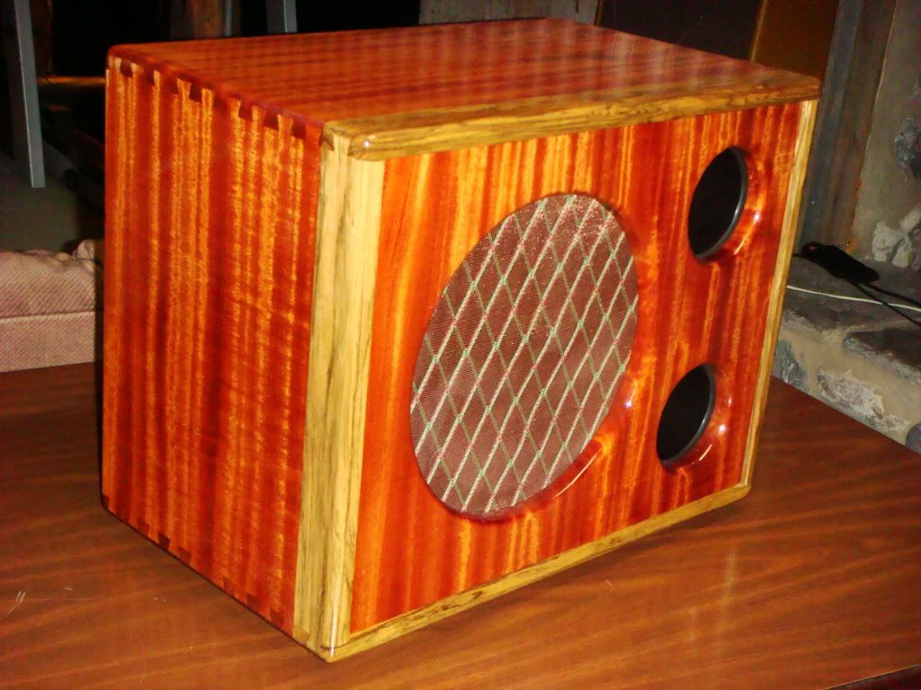

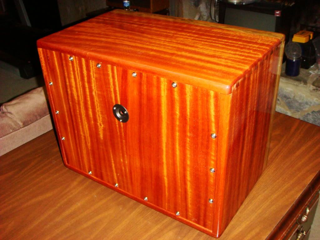

Here are a few pictures of a 1 x 12 ported cab I recently built for a friend of mine. It is loaded with a EVM 12L and the wood is nicely figured African Mahogany with some Black Limba trim around the front edge.
I have built several of these cabs and the thing that really surprised me was the cab sounded much bigger than a single 1 x 12 I had ever heard..

Rear loaded = clean look. Very nice!
Is the rear baffle also solid mahogany?
Also, what are the dimensions if that's not proprietary info.

Distortion wrote:Here are a few pictures of a 1 x 12 ported cab I recently built for a friend of mine. It is loaded with a EVM 12L and the wood is nicely figured African Mahogany with some Black Limba trim around the front edge.
Larry, once again, I am blown away by your work. Wow, that is a fantastic looking cab. Really well done man.

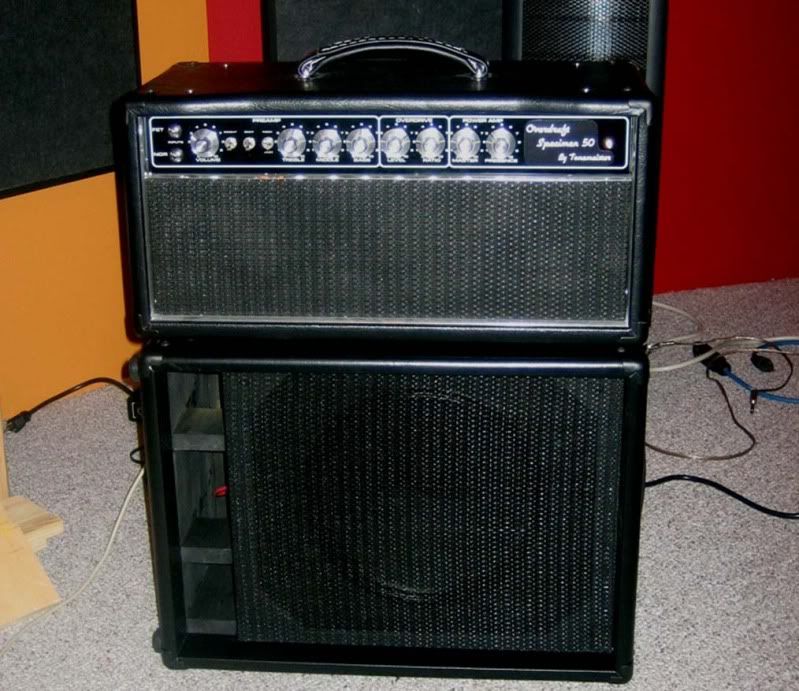

For what it's worth, here's a pic of a 'wide body' I just completed:

odourboy wrote:For what it's worth, here's a pic of a 'wide body' I just completed[/img]
Very nice dude! That's where I'm headed...basic black tolex 806 cab. I bet it sure sounds great.
