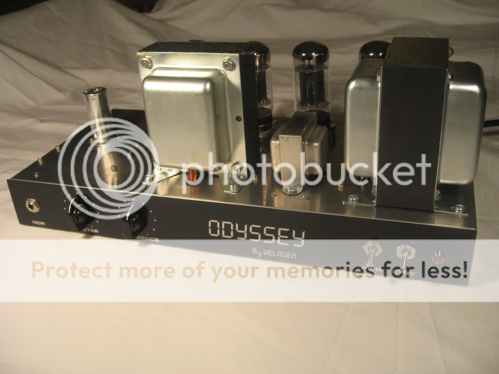

Has anyone done a built a dumbleatorII (stereo out)? I went to bed last night dreaming about an ODS combo with reverb and dumbleatorII with a matching oddysey combo.
