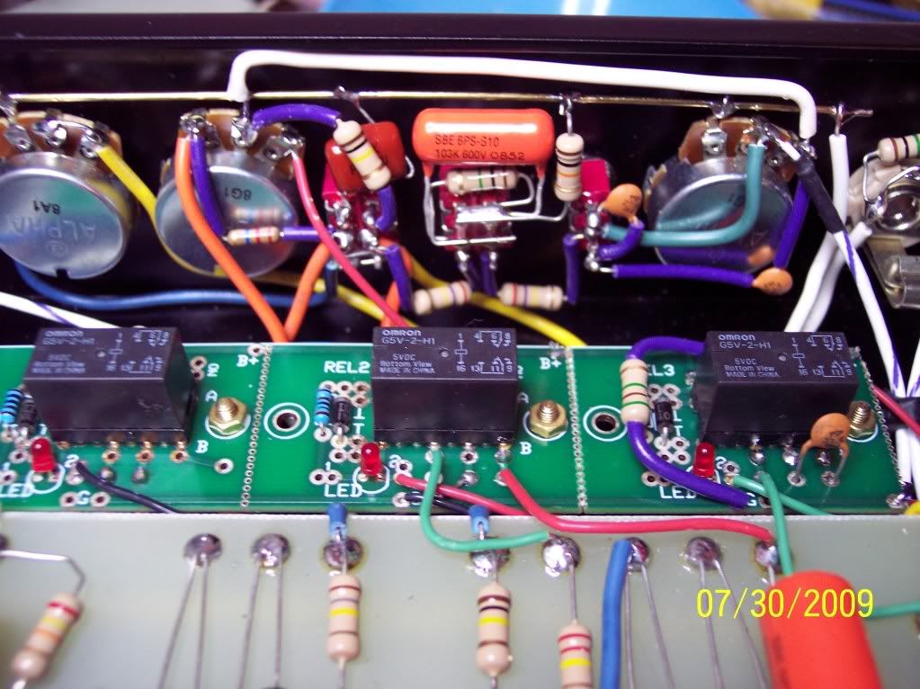

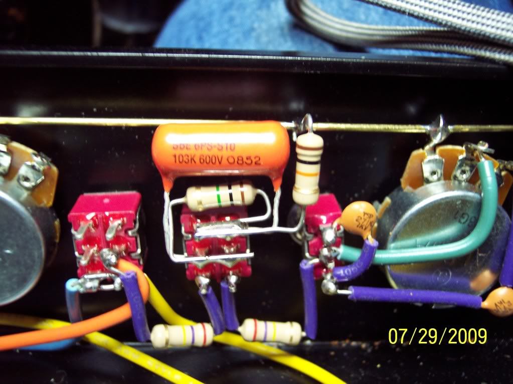

Guitarman18 wrote:Nice looking build leleduke!
BTW, you have the 24K(?) resistor going from the .1uf to the input of the PI and not to the resistor network. I noticed this in a previous build of yours and then it was changed to accept the coax(?) from the power amp in jack.
Cheers, Paul.
Thanks. 8) I can't believe I did it again.

Where is the treble cap?

dogears wrote:Where is the treble cap?
I have two on the 3 way switch.

I don't see them.... Can you post a fresher pic?

dogears wrote:I don't see them.... Can you post a fresher pic?
What treble cap are you talking about? The brite caps on the switch???

He means the 390pF in series with the .002uF you have on the board...it looks like it's not connected yet, judging by the red wire that goes nowhere on the rightmost lug of the treble pot.
Connected via a mid boost switch. Usually where you have your deep switch.
Its on the relay board.
