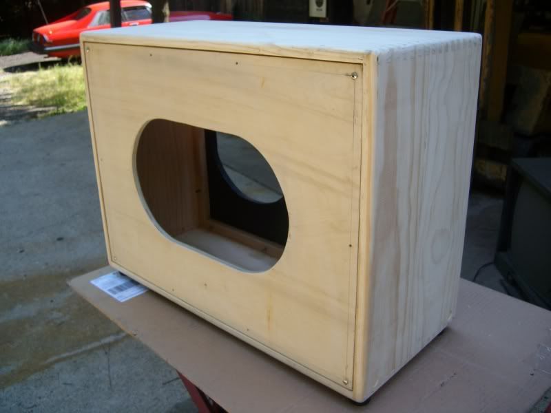

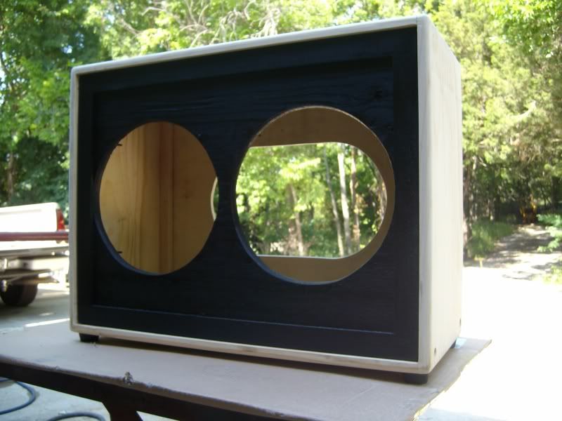

Here are some under construction shots of my 2X12 cab.

Re: SSS Texas style
Nice! What are you planing on putting in that 2X12" txblues ? Fine work so far ! Chad

Re: SSS Texas style
I am starting out with 1 Celestion G12H and 1 Weber 30 Watt Alnico Silver Bell. These sound real nice together. When money starts flowing again I'll try the Tonker and Swamp thang combination. Anybody want to buy a Jag with a Chevy 350 in it? Terry

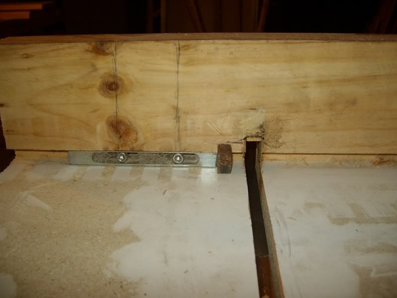

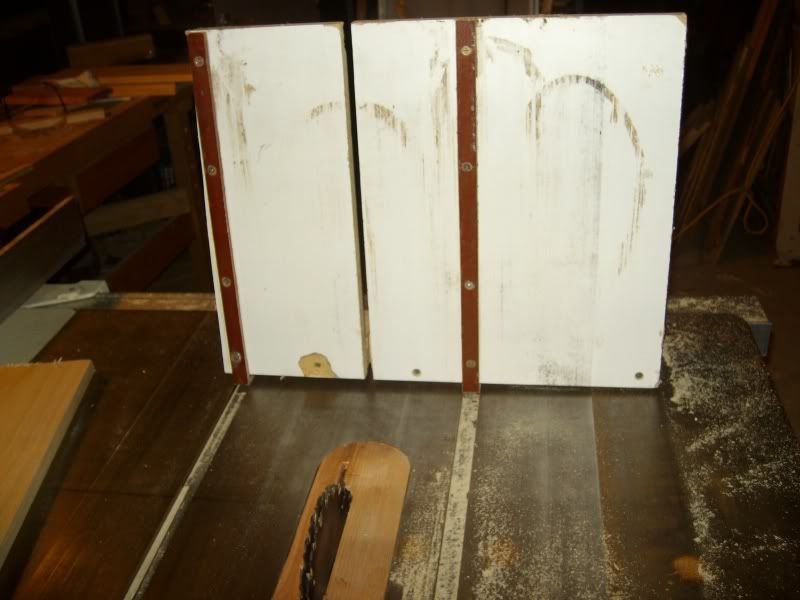

Pictures of my box joint sled.

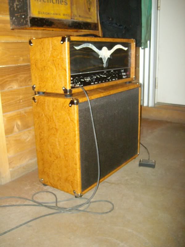

Re: SSS Texas style
Here's the finished head and cab. Still lovin it!

Re: SSS Texas style
Neat jig.
I think I could build something like that.
So you butt the board up to that finger you have on the jig and cut the first groove, then put that groove on the finger and just move along.
Something I was wondering, and this would apply to dove tails as well,
How do you calculate out the width of the boards?
You wouldn't want to go along then have half of a tongue or groove.
Do you use a router for the round over or just sand that with a palm sander?
txbluesboy
- Posts: 387
- Joined: Mon Apr 02, 2007 3:52 pm
- Location: Dallas area
Re: SSS Texas style
Yes Structo, You just butt the board up against the jig, cut a slot then put that slot on the stopper, cut another slot, repeat, repeat, until you got the whole width of the board slotted, then turn the board over,starting from the same edge as above. I normally start my cuts at the edge of the board that will be the front of the box. Cut both sides like this, then when you do the top and bottom boards' you have to start your first slot with a spacer the width of your slots against the stopper so you will start out with a slot rather than a finger on the front edge of the top and bottom boards. Watch that video of the jig you can buy, He uses the previously slotted board for a spacer. You will end up with partial fingers at the back edge, however, When you cut the other edges they will glue up to make a solid joint. I use a round over bit in a router on the corners. Once you get the jig spacing set right dont ever change it. Then you can cut the joints for a cab faster than the time it took me to write this reply. Terry
Re: SSS Texas style
Nice Build...I can see it, but now I want to HEAR it
Re: SSS Texas style
Thanks for the info.
So you use a dado blade, right?
And the little stopper thingy, that is mounted on that piece of metal there so you can adjust it where you want?
txbluesboy
- Posts: 387
Re: SSS Texas style
Structo, Yes, I use a dado blade, The stopper thingy is a piece of 3/8" keystock welded to the adjustable sliding piece. The width of the stopper thingy is not important since you are just sliding up against the side of it.
Dr. Who, Come on over if you get to the Dallas area and play it in person.
