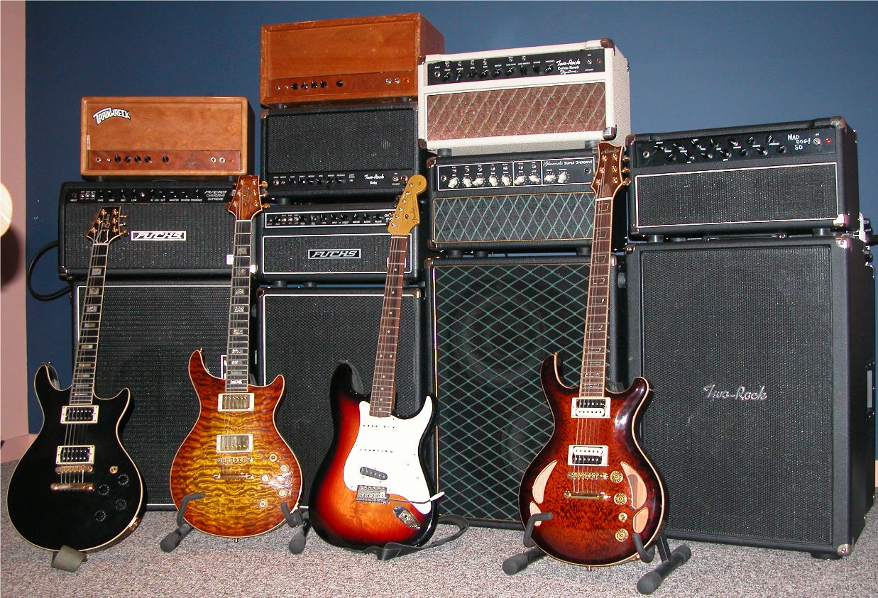

Which one?? (Not all mine. The Wrecks and Strat are Bill H's and the Two Rocks are Bob S's)
PS: Those are real Trainwrecks.
stelligan wrote:dogears,
Sell me your amp...... :)
[img:1237:843]http://www.scottlernermusic.com/pics/WallofDoom1.jpg[/img]
DaveBo32
Posts: 71
Joined: Sat Feb 24, 2007 3:44 am
Location: Salem, NH
Re: Question about strat tone through non hrm
Post by DaveBo32 »
Hold on...I have to wipe the drool from my dropped jaw...Now that's a wall of tone..... 8)
stelligan
Posts: 1465
Location: Nashvull
Post by stelligan »
You mean I can have my pick?? :) You vomitor of good tone..
P.S. Throw us a bone and post a clip with that there Stratocaster. ANd if that is a Tele pickup I see in the bridge - that is so not fair :wink:
