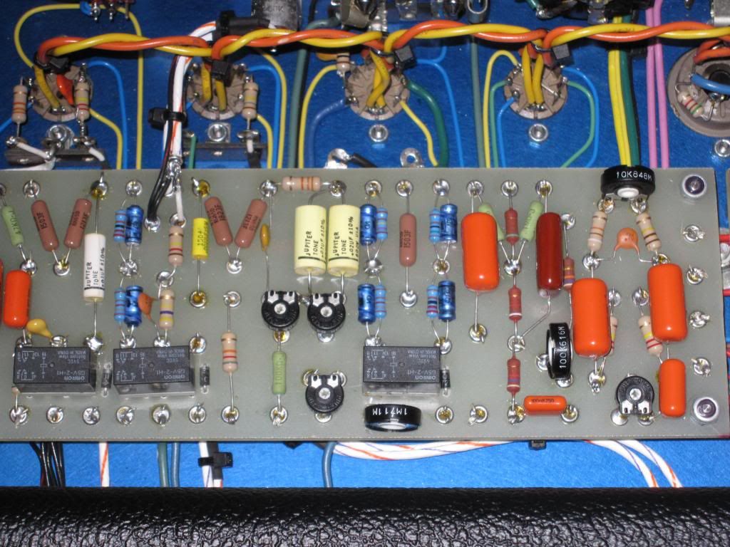

Here is a partial gut shot. Front of amp is towards the bottom of the photo. 3 small pots in the middle are the HRM EQ pots. It's the other 4 I'm wondering about- 3 vertically mounted and a smaller one horizontally mounted. Thanks for any help identifying and advising on adjustment of these.

Small pot at 6 o'clock is a high cut control that is triggered from the rightmost relay in the PAB mode only.

Thanks ToneMerc. Are these pots normally tuned by ear or value? Obviously I'm new to Dumble style amps so I'm trying to find my way with this stuff. If possible I want to be able to tune the amp myself instead of bringing it to a tech.
						Re: Brown Note Blue Monkey and Little Dummy Question
Look for guidance here: https://tubeamparchive.com/viewtopic.php?t=12875
Much good info on recommended settings for those trimmers and OD entrance trimmer in the first few posts. Happy trimmer trimming....

Adj Neg FB and hi cut are mainly season to taste. The OD tone stack trimmer settings will make or break an HRM and can require a fair amount of time spent to get the amp to your liking as well. FWIW, my first 100w D style amp was a BN BM reverb.Jjjp wrote:Thanks ToneMerc. Are these pots normally tuned by ear or value? Obviously I'm new to Dumble style amps so I'm trying to find my way with this stuff. If possible I want to be able to tune the amp myself instead of bringing it to a tech.
