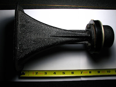

Here is that horn that was in it. I wonder if it is worth anything?
There is a oil filled cap can for a cross over in the cab.

Structo wrote:Here is that horn that was in it. I wonder if it is worth anything?
You gotta make a talk box out of that thing.
http://www.generalguitargadgets.com/content/view/197/
http://www.generalguitargadgets.com/content/view/198/
http://alexplorer.net/guitar/projects/talkbox.html
http://www.instructables.com/id/Make-A-Talkbox/
Yeah I had thought about that but wanted to see if it was worth anything first.
