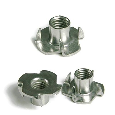

A T-Nut is a type of insert or blind nut that fits from the other side from the screw like a standard nut. But it is permanent mount and nearly flush to the surface.
- T- Nut

T-nuts have their place. In general, I'm not particularly fond of using them. In harder woods, I find the spikes bend over too easily rather than driving into the wood. They are fine for pine and plywood. I've grown to prefer threaded inserts over T-nuts. In any case, without a compelling reason or where appearance doesn't matter, I tend to avoid them as it is more work than it's worth. This is just my opinion. Everyone can and should use whatever pleases them.

T Nuts work well for me. As you said pine is a good wood to use them in and that is what I have used so far. On my head cabinets I install wood slide rails to facilitate installing the amp chassis into the cabinet. If I used standard nuts and washers they would protrude and interfere with the chassis sliding into place. T Nuts work well for me. If I try a hardwood in the future I'll probably need to find another solution, I'll certainly keep the threaded blind nuts in mind.

The T Nuts worked really well. I got #10s from Home Depot.
With T Nuts you still have a hole that goes all the way through. In my opinion, they are way less hassle than a nut and washer. When installing the screw you don't have to hold the nut and washer with your other hand. When taking out the screw you don't risk the nut and washer falling into the cabinet.
