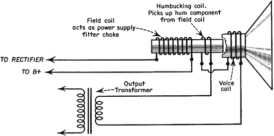

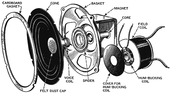

Stevem wrote: Mon Aug 07, 2023 3:41 pm This is where the hum canceling comes from that you mention.
Just wanted to chime in on this; some field coil speakers do indeed have a separate hum-bucking coil. It's wired in series opposing the speaker voice coil and is wound as part of the field coil. It is meant to counteract the hum produced by the field coil.
If you end up needing a new field coil speaker, feel free to hit me up. I've got several hundred vintage radio speakers.
